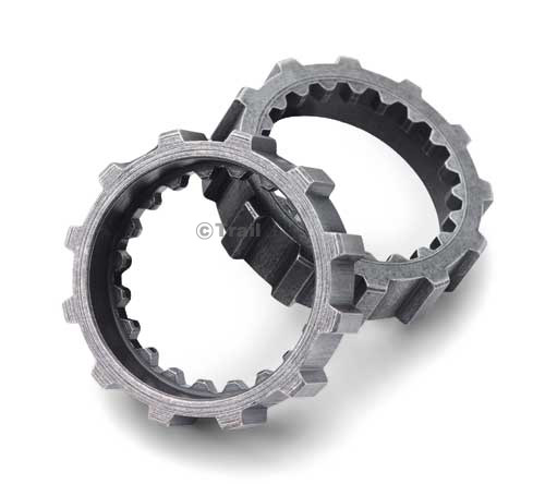

The fuse is basically a weaker ring that will sheer at a known amount of stress.
In this picture, you can see how the inner splines are greatly reduced in size;
http://www.trail.co.jp/pages/warn/wa...s/HubFuseL.jpg
