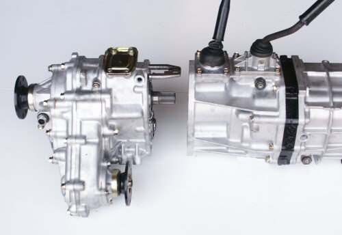

I've heard that but I don't know what's the difference from forward shift and top shift
Old Sep 2, 2010 | 11:30 PM
dark_fairytales's Avatar
Joined: Oct 2008
Posts: 1,621
From: Sacramento, Crawlifonia
top shift
topshift.jpg&t=1
forward shift
