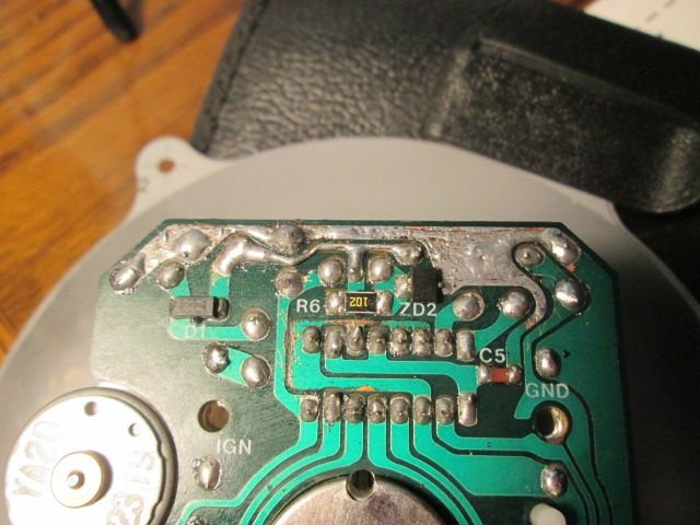

Went back to square one and strated over, I have what appears to be a burned trace. Trying to figure out what to do from here, I cannot find a replacement head locally or on a quick websearch. Could this be repaired by any electronics guy or is this specialized? Any and all input greatly appreciated

I weighted my options here and could not bring myself to buy a used speedometer on line, if I could have sourced one locally I would have done it.
I opted to get mine repaired, the tech said that due to age that 2 of the capacitors had leaked and damaged the traces and some of the solder joints. The bill for the parts and labor was $150 with a 1 year guarantee.
He also mentioned that if speedometer is acting up it is best to have it repaired quickly before extensive damage is done.
