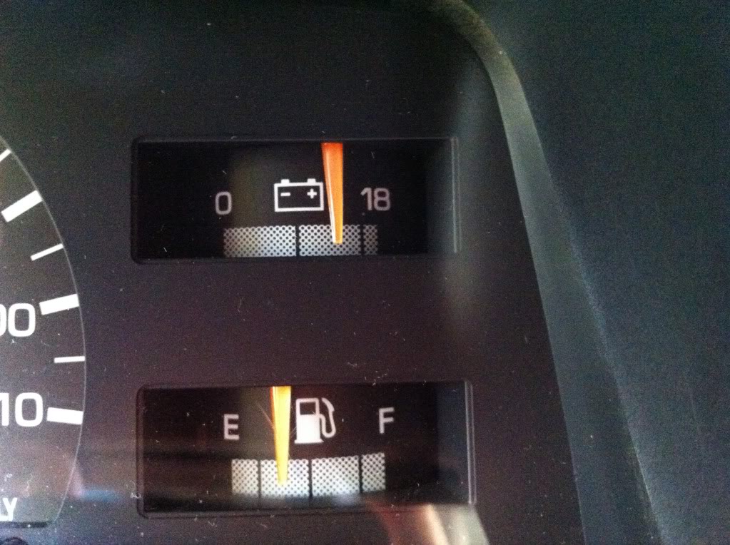

Hello, I just recently installed an SR5 cluster that has a voltage meter, I am new to this cluster and the meter. The gauge seems to be reading high in my opinion. It only looks this high at higher rpms, or while actually driving. It does go down to about what I guess it should be when its at idle. Does this look normal?

Just get a test meter and measure voltage at the battery whilst running the truck. Measure at idle and while revving.
If voltage does not go above 14.6 or below 13.6 volts at any point, you're fine.
