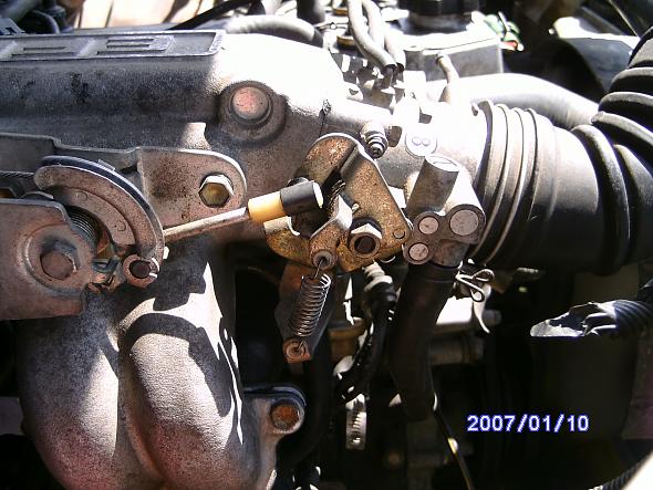

i was just reading up on the tps adjustment and noticed my throttle body doesnt have a dash pot or a stop screw.
think this could have something to do with the stalling out after i punch the gas?
