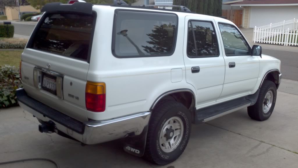

Would the wrong valve cover even fit properly? Both are leaking pretty bad on the back side so the manifold is coming off anyways. Plus I have to replace the knock sensor harness as well. Thats all, just had to introduce myself and vent at the same time. Heres my truck btw, 94 Sr5 4x4 5speed.

I'm sure you were expecting quite a bit of work, given what you paid. But it's a nice looking 4runner, and I expect you'll come out way ahead in the end.
