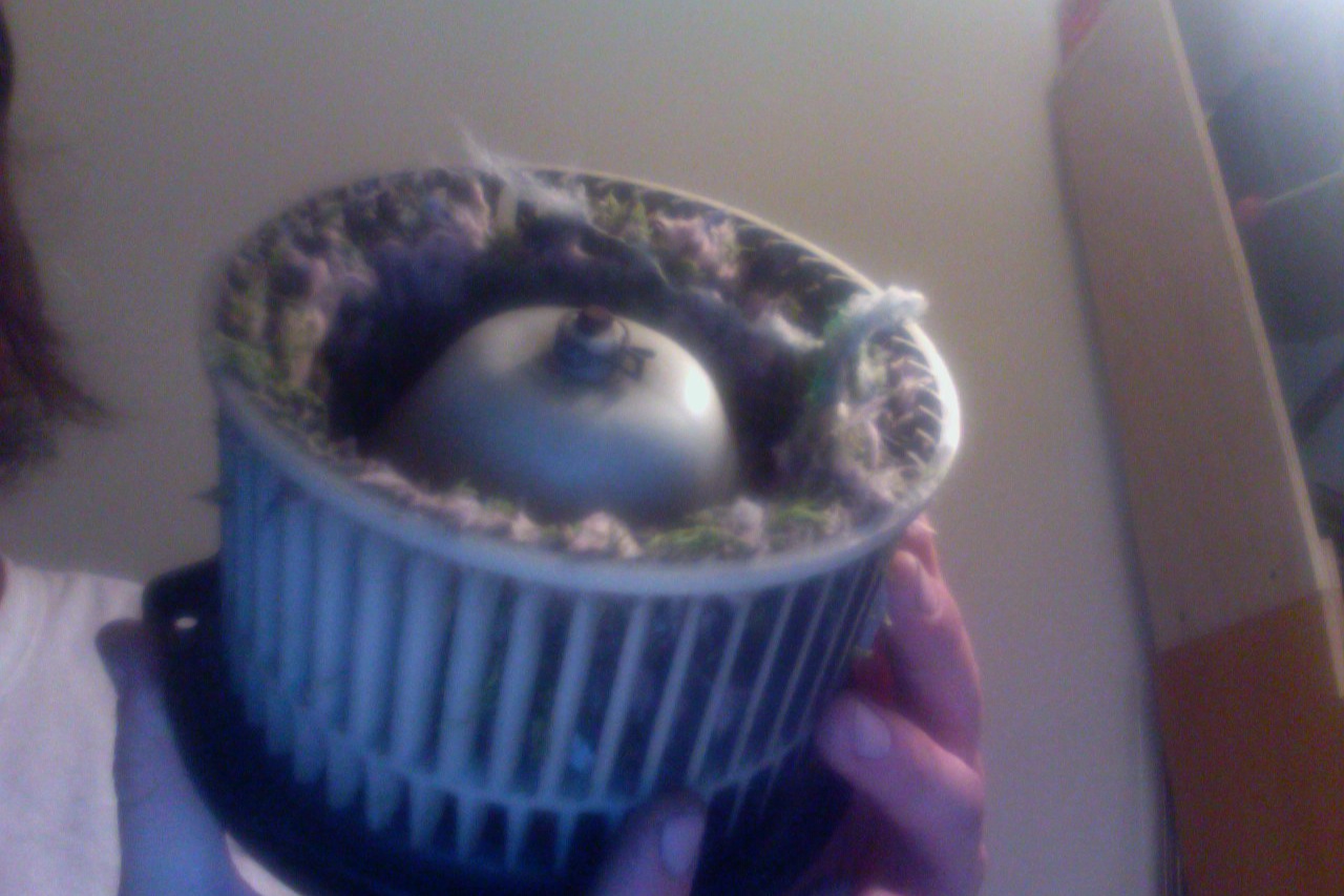

- Blower motor recently ate it (it still runs, but poorly and sounds off balance.) I think a recent surge due to a bad voltage regulator may have done that, but not sure. I already replaced the alternator.

My rig has all factory-labelled vacuum hoses, and I would hate to lose that. So I will only replace a vacuum hose if it needs it. You can make any hose last a lot longer by warming it up to remove it; I use a heat gun but that's really too powerful. A hair dryer would be just right. Once you get the hose off (and warm) squeeze it. Did it crack? No? Keep it. I'm sure silicone vacuum hoses are very pretty, but the rubber ones have already lasted 20 years. If your replace them with ordinary rubber, you're just gonna have to replace 'em again in 20 years ....
A voltage surge could fry a motor, but if that happened I would expect it to be dead, not noisy. My guess is that you've sucked some dirt in there. You might be able to clean it up, or you could have trashed a bearing (which will not be worth replacing).

Scope103 brought up a good point on the blower. You would be surprised at how much dirt and debri gets into the ventilation system. I have tried to show it a few times in some threads along with some pictures. Under the windshield cowl on the passenger side, it eventually leads down to the blower. Leaves and such can throw the fan blade off balance.
I would suggest to pull the blower motor out and there is an 8 mm nut that holds it to the motor. Pull the blade off and take a compressed air and blow the dust out of the motor assembly. Most likely it will be dust off of the electrical components. I dont fully understand electric that well, but if the dust is from the brushes like on alternators, usually I get alot of dust out of it. It will be black, fine, gritty dust from the electrical components.
If cleaning it doesnt fix it, just replace the blower motor. From my experince, a blower motor just stops working completely from being used all the time and all at once. Really no warning of it going bad.

Well that's awesome... blower motor discovery :)
Now, as I type this, the blower/squirrel cage fan is sitting on my table waiting to be cleaned out, but I wanted to show what it looked like when I finally got it out...
Testament to the truth of what the PO said about both the truck sitting on their property unused for more than a year, as well as the son driving around the muddy power-line access road. There is enough moss in this thing to cover a PNW tree, and enough dirt/dust/lint/fuzz to fill the belly buttons of every man in America. I'm gonna clean this little guy up and throw it back in. Hopefully it will quiet things down
