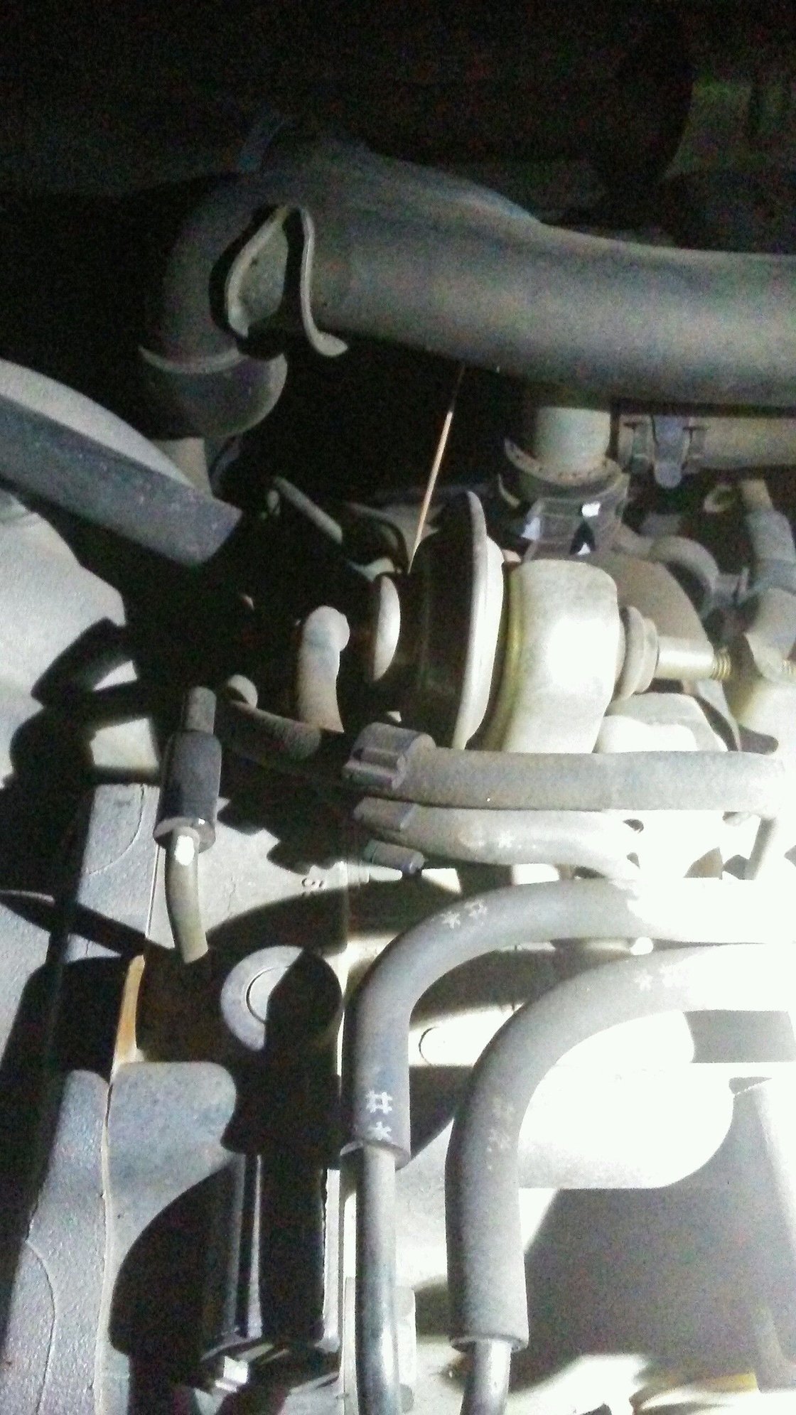

This is the 94, you can see the stub on the right that is capped with a screw and short piece of hose, (was just purchased), the lose vacuum line is the stub that is capped on the 95 but where they had it ran to right now.
This is the 95 where the stub is capped.

See if this helps: This is a '94, but I believe the capped port is in the same place on all 2d gens.
The labels on the throttle body are P, E, R, with P going to the TVV to the Evap Canister, and E and R to the EGR Modulator.

That's definitely it. Looks like the guys that rebuilt it put the vacuum in the wrong position. Still wondering what that cap is for why that stub is there. I'll get it changed around as I'm gonna put in some new vacuum line, some of them are very lose.
