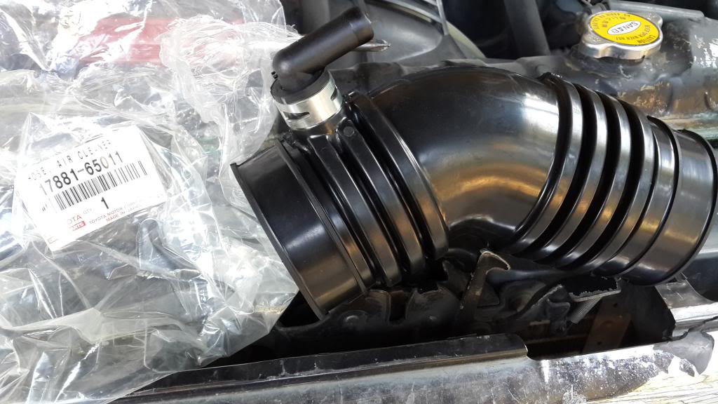

Hi all, last week i was able to locate a vacuum leak in my 93 4runner from the rubber duct connection from the MAFM to the throttle body and since i could not find a used one i had to buy it from Toyota dealership at 80 US$

After installing it, idle went up to 1200 RPM and since i previously calibrated the AFM i had to do it again to try to get it to 800 RPM.
And now we come to the question, how much is it normal to open the idle screw located on the throttle body? mine is open one full revolution.
