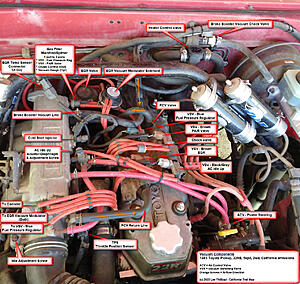

Vacuum components & diagram for 1993 22RE California
I took a picture of my engine then labeled all of the visible components. It should be helpful for troubleshooting and modifications. It's a 1993 truck, 22RE, 2wd, 5 speed, California.
Let me know if anything can use more detail or I got anything wrong.
Attached Thumbnails Vacuum components & diagram for 1993 22RE California-engine-compenents-labeled.jpg   Vacuum components & diagram for 1993 22RE California-22re-california-manual.jpg

thank you for taking the time to do this it really helped me out!
I’m assuming this applies to Automatic Transmission as well? Cheers

life saver!
I adjusted my valves and need less to say hoses came off and this was EXACTLY what I needed! Thank you very much.
