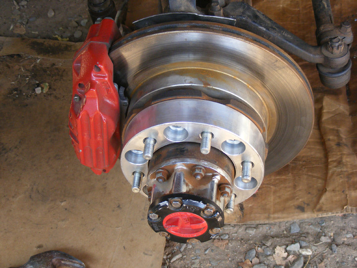

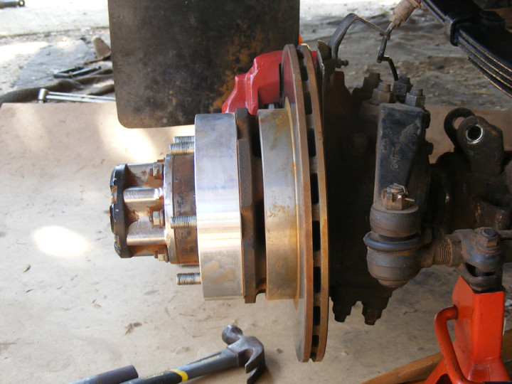

You'll need wheel spacers to clear V6 brakes if you have a SFA. Mine are 1.5" as shown in pic
I used fj60 vented rotors (any year fj60 works), a 1" mc from a 94 v6 4runner, and my calipers and pads are also from a 94 v6 4runner.
I tried to squeeze in the 94 v6 4runner dual diaphragm booster on mine, but it hit and rubbed my steering column since it was too fat and thick. My solution to this was to get one off of a 2wd v6 pickup which was also dual diaphragm but just a tad skinnier so it didn't rub my steering column. and yes you'll have to bend the hard lines just a little.
For cleaning I just used purple power and a brush. 3 coats of primer and 3 coats of red engine paint.

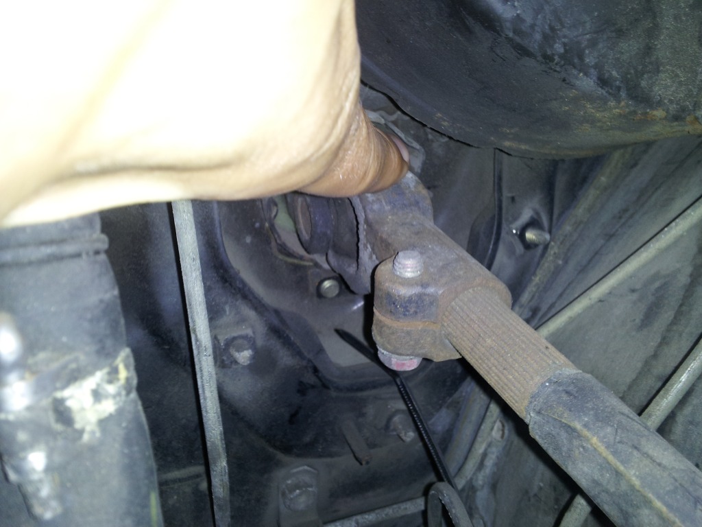

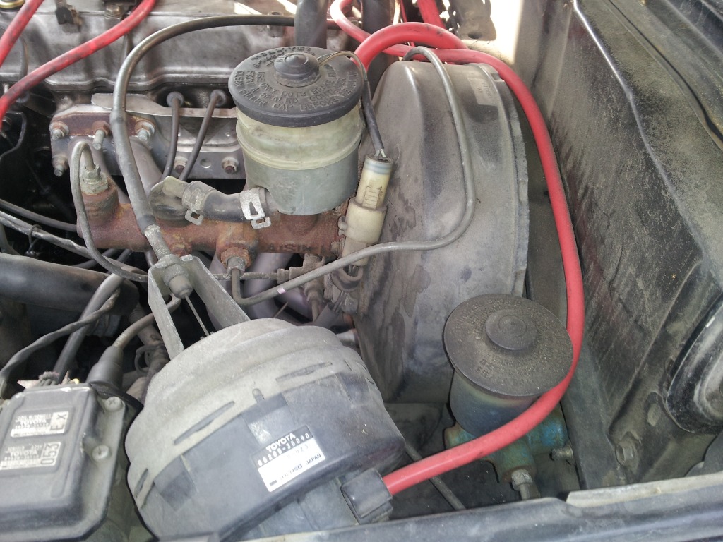

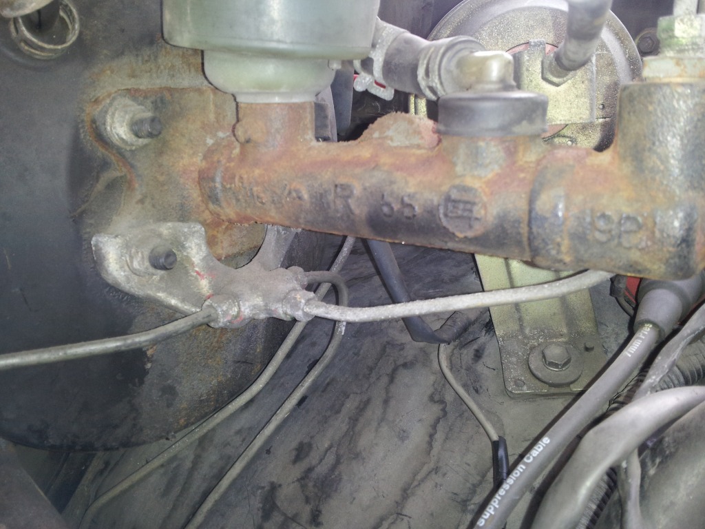

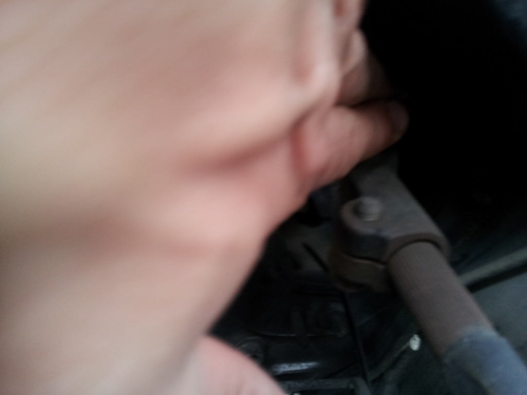

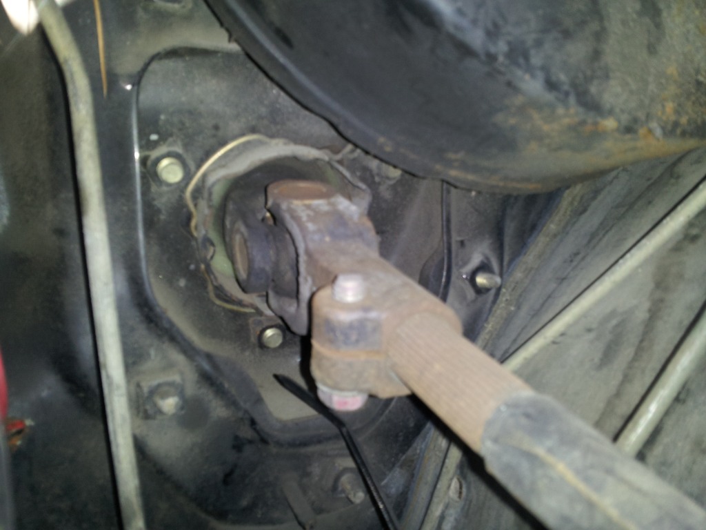

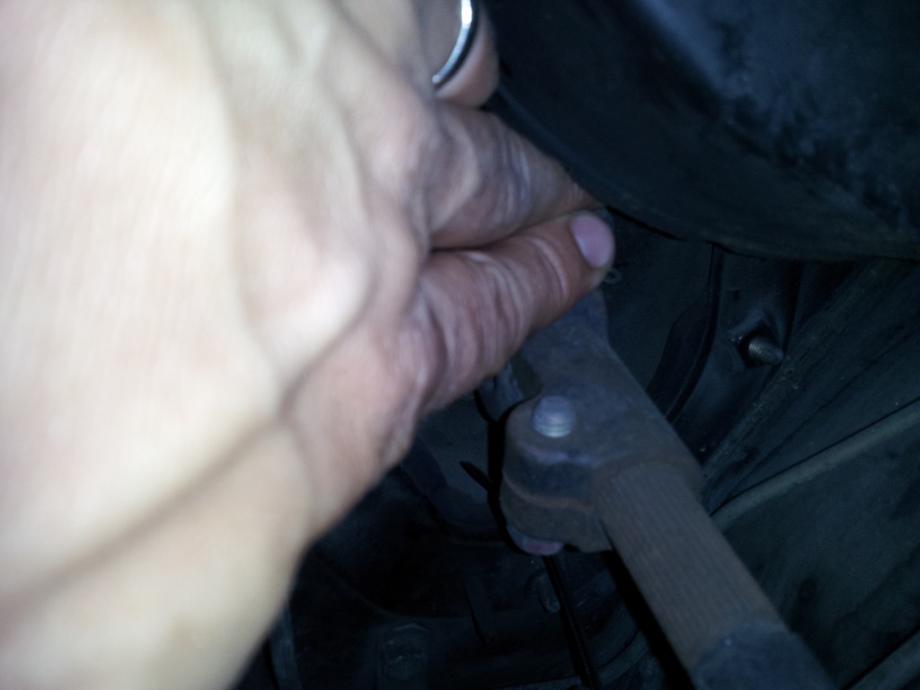

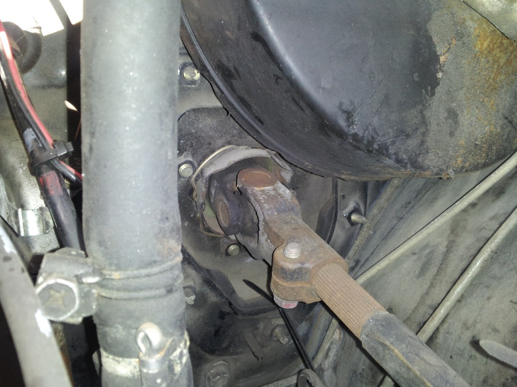

OK, here are some snaps I took today of my current setup.
Looks like 13/16" MC on the rusted casting
I can fit between 1 and 2 fingers in between the bottom of the booster and the steering column.
