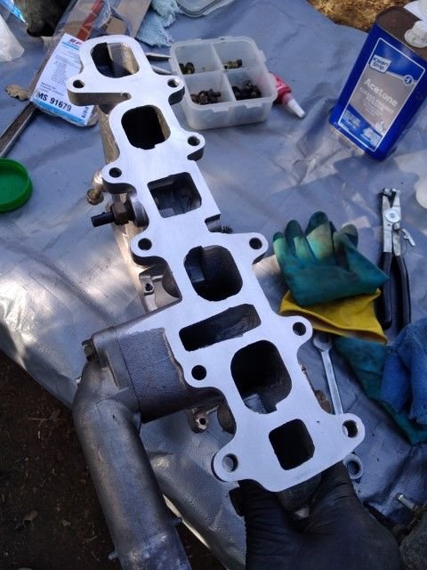

I recently cracked the thermostat mount on the lower intake manifold of my 94 pickup. The replacement was going well until I found a forum thread where the torque specs were given incorrectly and I may have pulled the threads of some of the holes of the engine head. Basically I was not confident about getting them to hold reliable torque. The result is that my engine is not burning coolant and running rough as a result. Starting the engine recently resulted in some fire cracker sounds from the tail pipe that first thought was throwing a rod, but the engine eventually turned over and made it back home. I thought of handing the project off to a shop and telling them some of holes in the head may need thread inserts. Though I just got a right angle attachment for a drill and have contemplated attempting the repair. The tightening sequence also seems fairly important for seating the gasket and think I have the proper torque spec now. Anyone with similar experience or advice?

Torque specs for the intake bolts is fairly low, around 14 ft/pounds i believe.
Installing helicoils is fairly easy. You're just drilling an existing hole a bit bigger. Just don't go deeper than you need.

14 ft-lbs is correct. https://web.archive.org/web/20121110.../7cylinder.pdf (page EG1-33).
Installing helicoils is fairly easy, but it's even easier to install them badly. You want a perfect hole to tap for the helicoil. Absolutely use the correct drill bit, and do your best to drill a straight hole (don't egg it out). Ideally, a mill, or at least a drill press. Why? Since the helicoil turns in the same direction as the bolt, it's not hard to get everything to hold together even if you did a sloppy job. But if anyone ever removes that bolt, the helicoil will come out with it if it's installed badly. You don't want to deal with that.

High-temp threadlocker for the threaded insert after cleaning the threaded hole with acetone, though I am wondering if there will be room for my drill in the engine bay because I am not removing the engine in my driveway. I guess it may be important to not use an insert that is too long to allow the part that is broken off with a punch to find a resting place that doesn't interfere with the fastener?
The tightening sequence is also important for compressing the gasket evenly, although I do not see instructions for this in the link..
is there an easy way to purge the fuel rail before disconnecting it?

I'd measure the depth of the existing hole, then mark that on your drill bit so you avoid going much deeper than the hole already is.
As far as torque sequence, I'd start in the middle and work my way to either end, up/down as I go.
