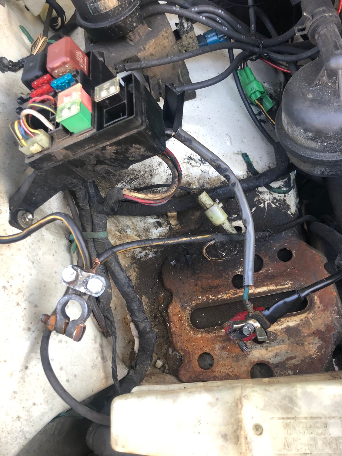

Wrecked my truck. Drive fine for weeks then the battery light came on. Parking Brake light doesn’t light up. An i changed the alternator twice and battery light is still on. Could i have a bad connection on my 80amp fuse? Or bad connection at alternator plug?
Fuse box damage
Alternator plug wiring

First, repair those alternator plug wires. At the very least, pull the pins out of the plug, put some heat shrink on the wires, and put the pins bak in. Best whould be to pull the pins, clip the wires at the far side of the break in the insulation, and crimp new pins on, then re-install them into the plug.
Second, I would pull the wire going to the fuse box off the positive battery terminal, and clean it thoroughly. It looks somewhat corroded, and even a small amount of corrosion can completely break a circuit.

Bad wiring.
Here.
