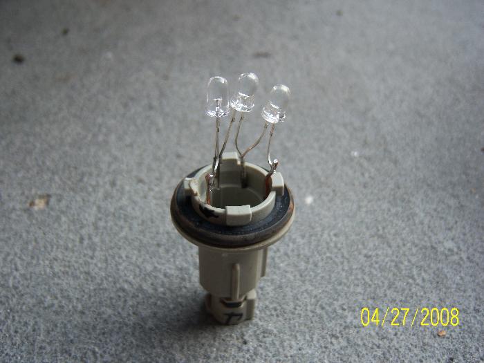

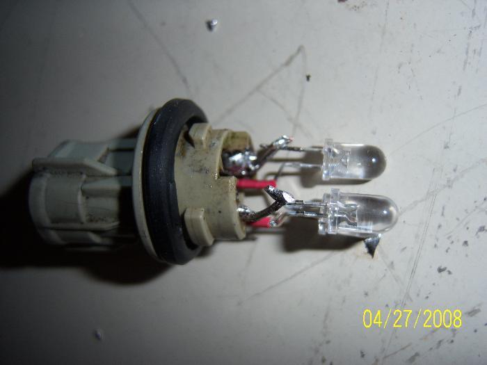

now thats funny. Heres some pics I will have them up on my site tomorrow, working on writing the code now. I will take a night shot of it with all the lights on. Im kind of wishing I took a before pic for comparison, but oh well. So far it looks great.
ummm, aren't you supposed to put in-line resistors in those little LED bulbs when hooking them to 12 volts? There only suppose to take like 5 volts, maybe 7 max if I remember right. I mean, they may work now, but chances are they'll burn out very quickly.
That's the reason I just bought direct replacement LED bulbs pre-resistored that plugged right in instead of doing all that with my LED tail lights, turn signals, blinkers, dome light, and dash lights.
Also, the lower power needed for the LED blinkers makes them flash twice as flash; or in my case, I rewired an aftermarket flasher and now they actually blink half as fast as stock, lol.

oooooh, never mind, their hooked in series and you did use resisters, lol, my fault, didn't notice that till I looked at your mod page...
Good Job!
