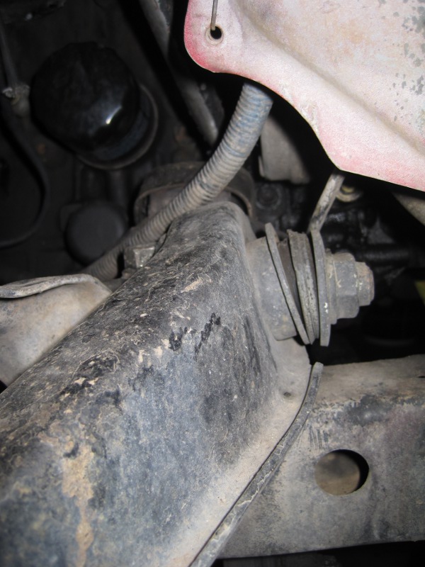

Hi all,

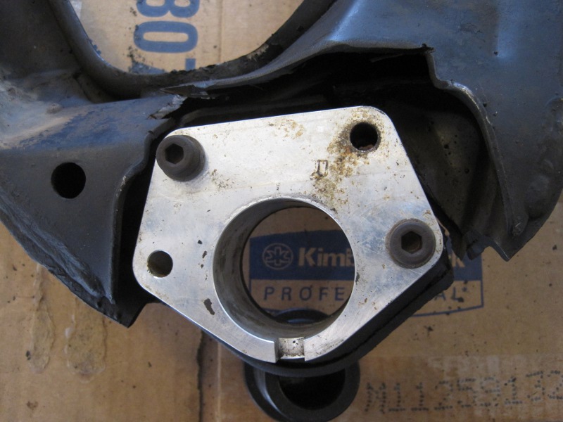

My right upper control arm (aka upper suspension arm) is toast (see attached).
And since I'd really not tear is apart to R&R the UCA only, what else should I being doing while I'm in there?
I have several questions before I proceed...
1) where should I get control arm bushings? Part numbers?
2) same question regarding ball joints?
3) if I decide to replace the torsion bars, where should I get them? Who sells OME at good prices?
4) while I'm in there, are there other suspension/steering parts I should R&R?
5) good source for shocks?
6) do the CVs while in there?
Thx,
Jon

Originally Posted by illzoni
Hi all,
Lol, I was all set to say it wasn't a great picture what are talking about then I saw the enlarged photo and wondered how I misssed it the first time.
Well if you just want to throw money at it. Get a metal fatigue penetrating dye kit. Strip all the paint and inspect, repaint and/or replace whatever.

How did you manage to snaggle that control arm up like that? You been jumping that thing?
Dunno. Definitely no jumping and haven't off-roaded for a while. Heck, I haven't offroaded since well before driving Tucson > Murfreesboro a year ago, towing a trailer with two motorcycles. Maybe whoever trimmed the UCA for the ball joint spacer got carried away and the crack has been expanding with time?

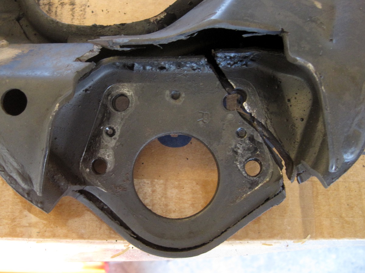

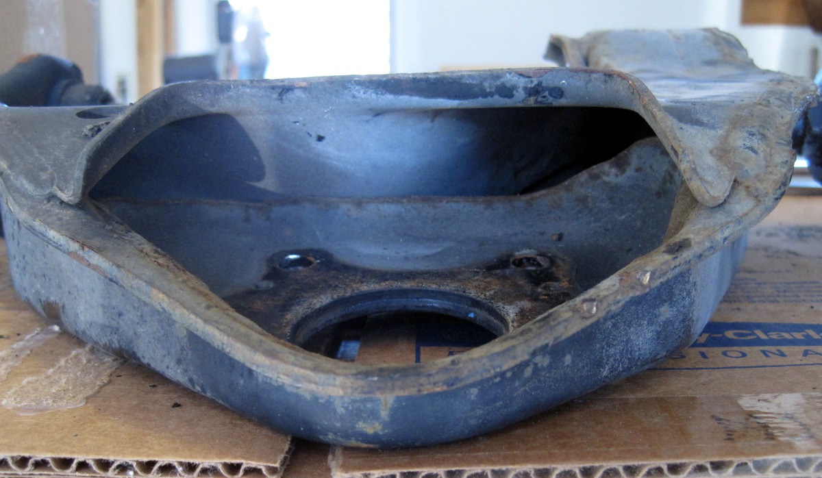

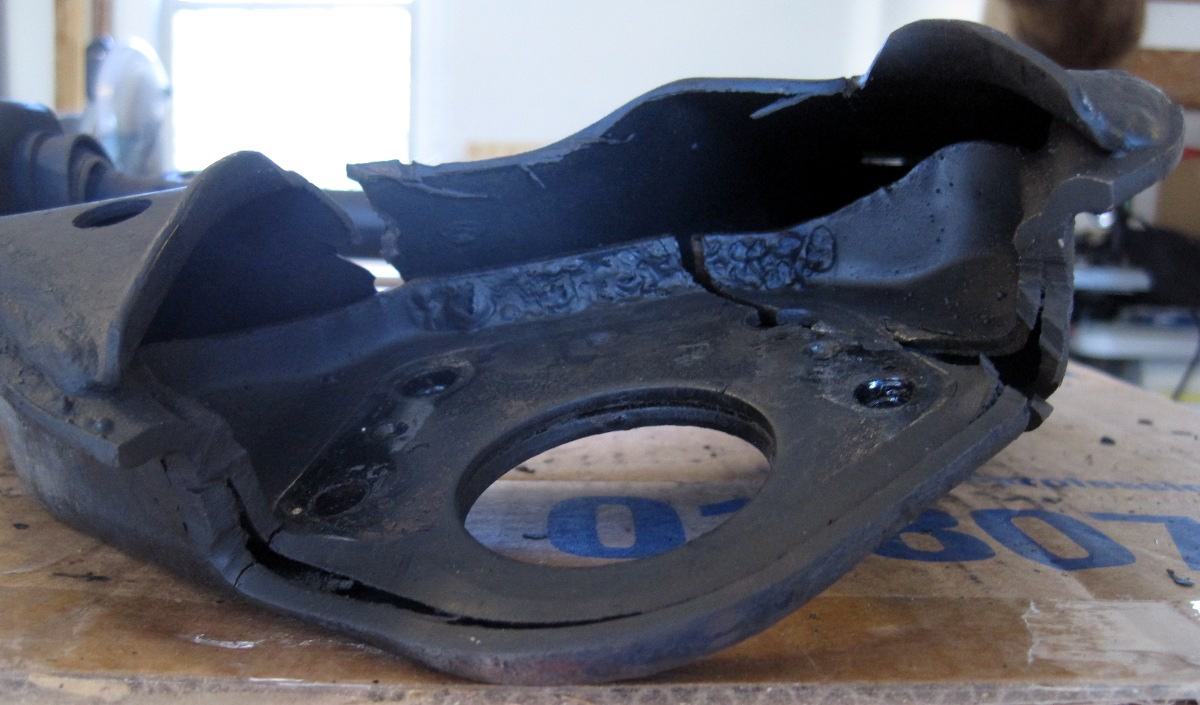

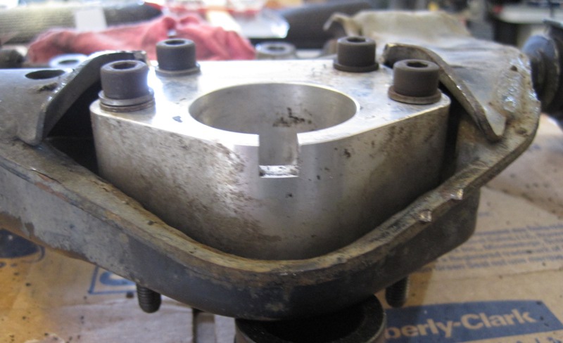

Now I have the damaged upper control arm out. I put each on the workbench upside down and snapped the attached photos to illustrate the problem.
Attached Thumbnails Tuning Up '87 IFS Suspension-130203_2464.1200.jpg   Tuning Up '87 IFS Suspension-130203_2466.1200.jpg
Old Feb 3, 2013 | 12:38 PM
illzoni's Avatar
Joined: Apr 2012
Posts: 17
From: The Boro TN
As you can see, whoever installed that BJ spacer removed way too much metal from the control arm. These photos best illustrate the damage. Fortunately, they didn't do the same on the driver side.
Attached Thumbnails Tuning Up '87 IFS Suspension-130203_2467.1200.jpg   Tuning Up '87 IFS Suspension-130203_2468.1200.jpg

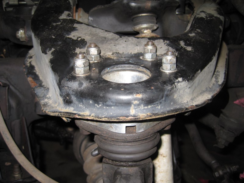

So here's where I'm at...
The truck is sitting on jack stands on the front end. Both wheels are off. I had to remove the front bumper and skid plate to get proper access, so the bumper is hanging from cargo straps and the skid plate it out of the way.
Completely loosened both torsion bars. I was able to pull the passenger side one rearward to remove. The driver side is a bit more snug, but it's not a priority at the moment and I'll get back to it.
With the passenger side torsion bar removed, I was able unbolt the upper ball joint and spacer from the upper control arm, then unbolt the upper arm shaft to completely remove the control arm. The front of the control arm was twisted pretty badly....I took a pry bar to it but that wasn't enough to get a socket on the the forward arm nut, so I had to finish creating clearance with the angle grinder.
That's where I quit for the day as I haven't a clue how to get the arm shaft and bushings out. Please help?!??!?!?!

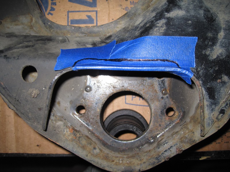

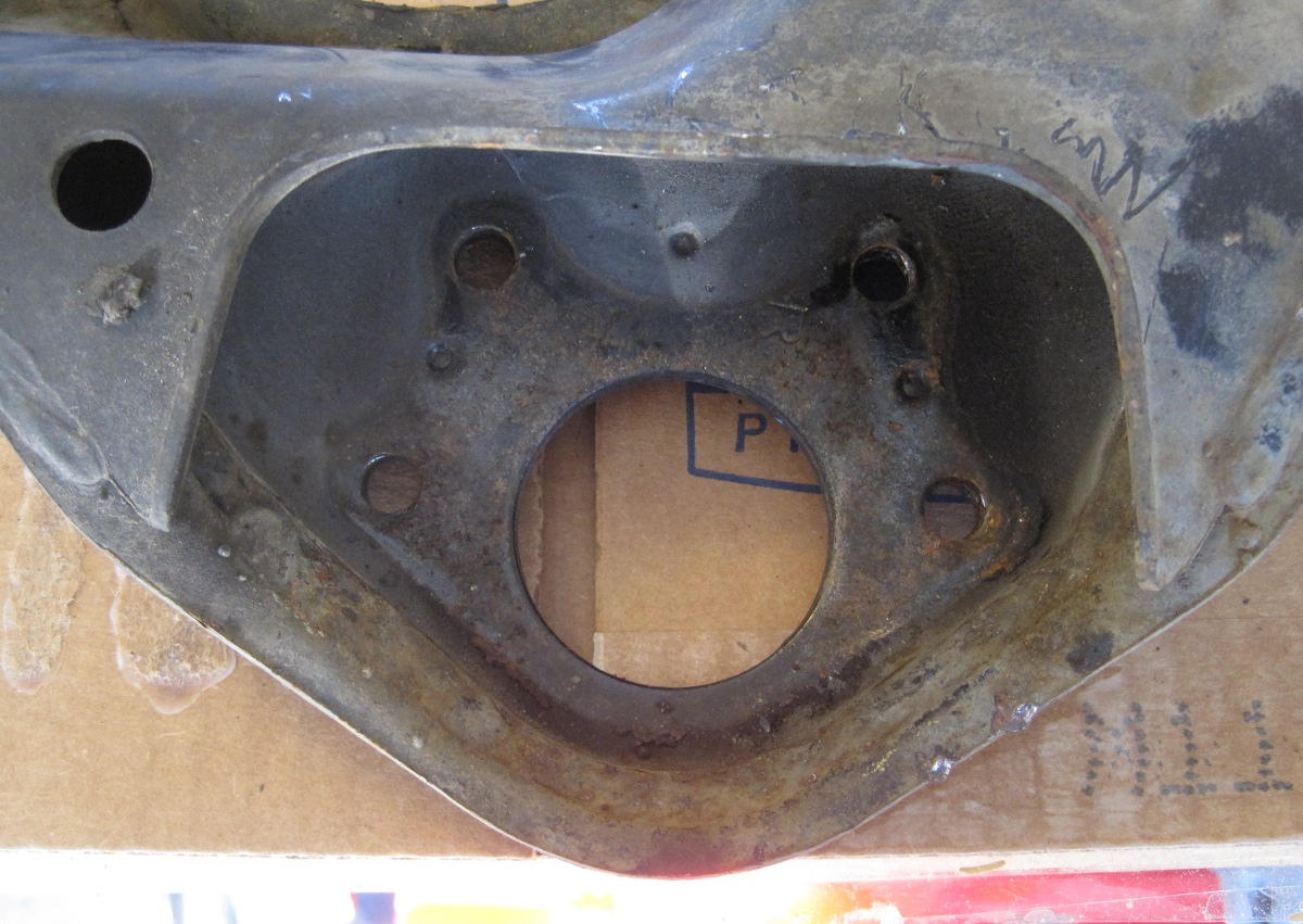

Since my T4R is my daily, I needed to get it back together ASAP. I skipped installing the new bushings and ball joints, just trimming the salvaged control to fit the ball joint spacer and putting it all back together.

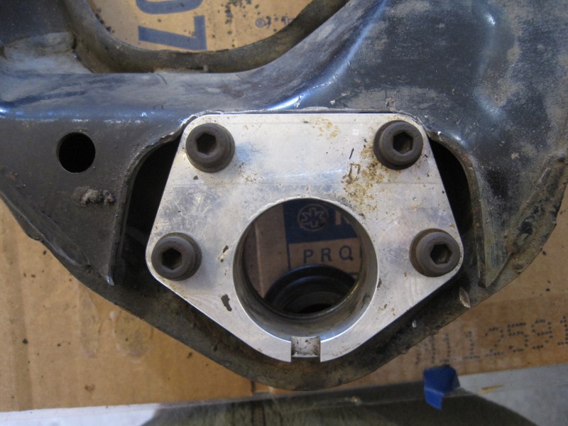

The first photo illustrates how much space was around the spacer--the previous installer cut way too much!
I didn't want to make the same mistake, so I taped the control arm and traced what I thought would be the minimum to make it fit. As you can see in the third photo, it's a pretty snug/good fit.
Attached Thumbnails Tuning Up '87 IFS Suspension-130204_2479.0800.jpg   Tuning Up '87 IFS Suspension-130204_2472.0800.jpg   Tuning Up '87 IFS Suspension-130204_2476.0800.jpg

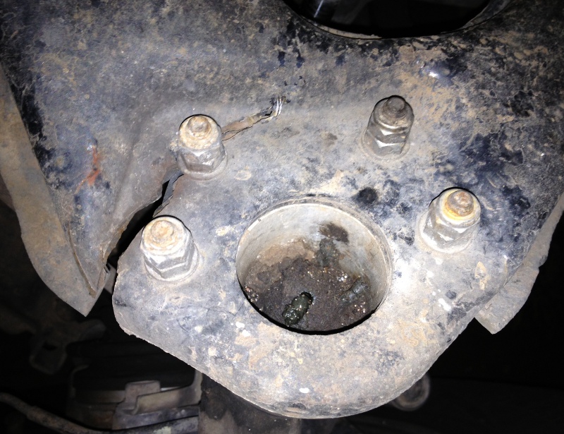

These next two photos show the old and salvaged control arms with the spacer loosely installed. It illustrates again how the previous installer had cut way too much!
And, finally, here it is installed on the 4Runner.
