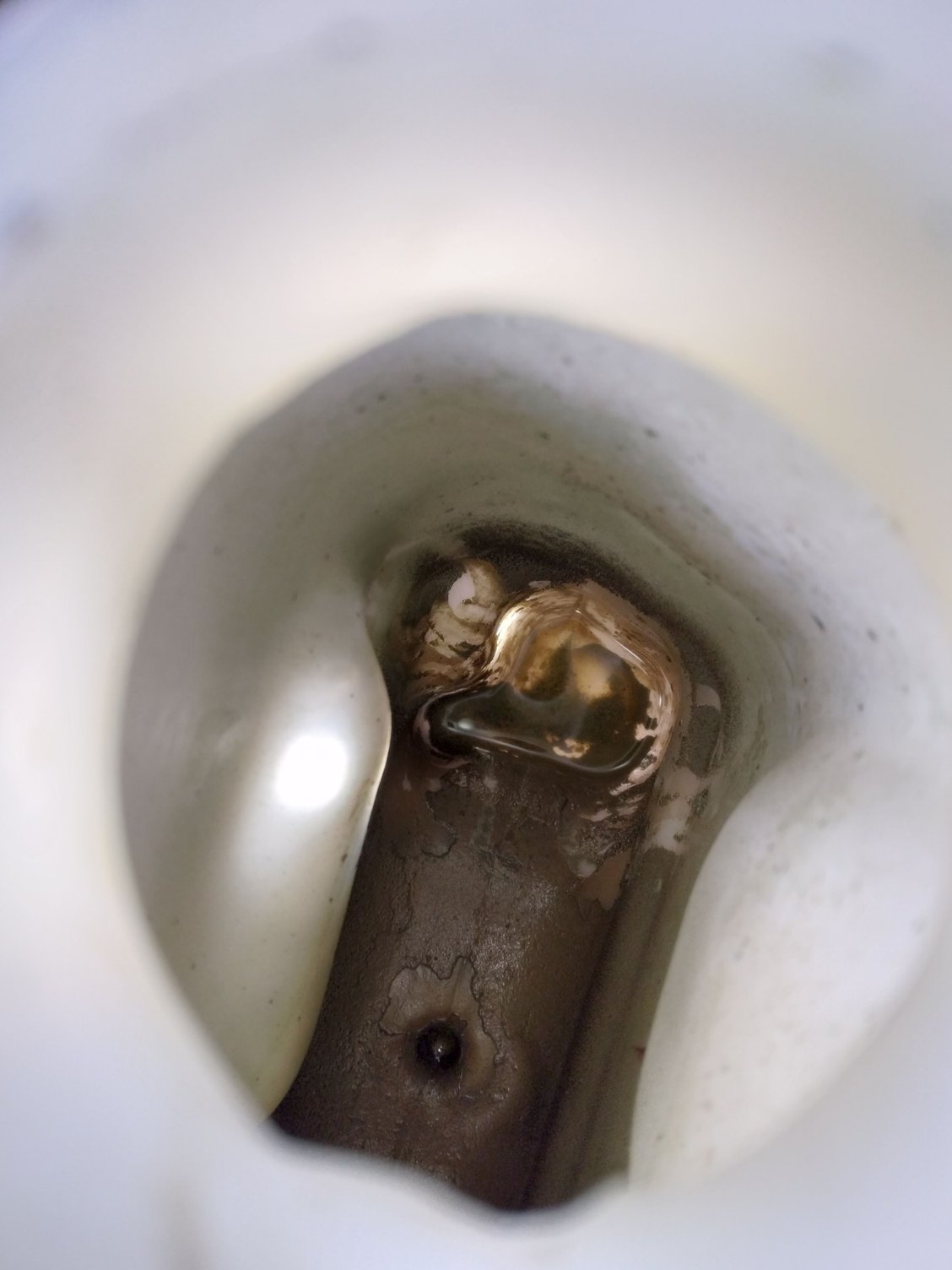

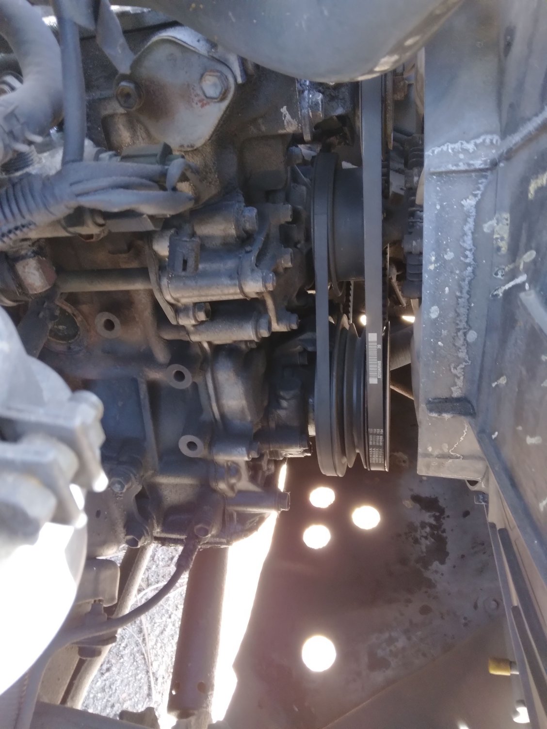

Was driving 89 Toyota truck with 22re engine and suddenly a loud squeeling sound happened and we pulled over. It was still able to start but the squeeling noise continued seemingly coming from the belt. I am wondering of course if it's a blown head gasket. I looked and saw that the coolant was very low but unfortunately my gauge apparently wasn't working so it didn't alert me. I have attached some pictures and hoping someone maybe knows something. This truck has been good to me and I'm very bummed out.

Having experience such symptoms on both my 87's, I would say oil pump, and/or harmonic balancer. If it's still in time, I'd put my money on the oil pump. Either it froze, or one of it's two gaskets failed.
Surprizingly easy to remove the oil pump and change both it's gaskets. Hard part is getting the bolt holding the harmonic balance broken loose. There are special tools recommended, me, I use the heavy breaker bar, an impact socket (19mm, IIRC), and the starter to break the bolt loose. I pull the coil wire, make certain the truck's wheels are chocked, and only the trust with my life, my lovely wife, in the driver's seat with the key.
I hold the breaker bar tightly against the passenger's side frame rail, yes, I lay under the truck length wise, and have her tap the key. TAP the key. Twice, if necessary, but just a quick tap on the key to make the starter engage and turn a little.Breaks the bolt loose for a treat. Many people say this method is way too dangerous, but it's worked for me for 30 years plus.
DON'T LOOSE THE KEY HOLDING THE BALANCE TO THE SHAFT!!! I do every time, and have to spend an hour with a magnet searching for it.
The front crankshaft oil seal can be tapped out using a socket that JUST fits the oil pump opening. Tapped back in with the new one as well, you just need to flip over the pump from removal position. The small, oil pump seal is a PITA to keep in place during installation. I like to put a dab of a thick, heavy, grease around the channel it sits in. It holds the seal in place without changing the dimensions of the channel at all.
If the pump's actually frozen, you'll obviously need to replace it, as well as the two gaskets. They're readily available, and not very expensive. Make sure to use all new OEM parts! No after market stuff.
If that aint it, I apologize for wasting your time. May well be the head gasket, but check the oil pump seal, and the front crankshaft seal, and so forth, first.

I don't think we really have enough information to know what is going on.
I am doubtful of the oil pump failing. The oil pumps in these trucks is very simple and robust, and is the first thing to be lubricated by oil. Usually the rest of the engine will fail before the oil pump will.
Is the coolant in your radiator also low, or just the overflow tank?
Do you know for sure if the overflow tank and radiator were full before this happened?
The first picture looks like oil residue coming from the PCV valve / hose area. That could be caused by several things like a plugged PCV valve, a old and hard PCV valve grommet, and/or excessive blow-by from the crankcase.
The squealing belt may be caused by something on one of the belts paths that may be seizing up.

HOWEVER, the pickup is on it's 4th set of oil pump gaskets (ie:3 new sets) at 372,000 miles, all catastrophic failures, and the 4Runner on it's 3rd set, at 173,000 mi. Almost always the oil pump's outer gasket failed, dumping the engine's oil out right on the spot, covering the engine as the oil slings up all over from the spinning crankshaft. Every time, it looked a lot like what the pictures showed.

Oil pump O-ring and crank seal is one of the most common repairs done on the 22R#. So four times over 372,000 miles is pretty textbook.
The staining on the valve cover is nothing. Maybe grommets getting old, but no cause of odd sounds or external dripping.
Need to do more investigating, but by your description I might look at the waterpump first and make sure its ok.
