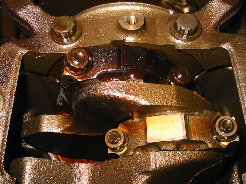

I spun a bearing and I have some pictures of what things looked like inside in my rebuild thread. I had a bunch of metal shavings at the bottom of the pan, and in my case, the crankshaft was too far out of spec to be saved. I did the whole machine job and rebuilt it myself, but I pulled the engine out to do it.
Here, a picture of the endcap at my bad bearing:

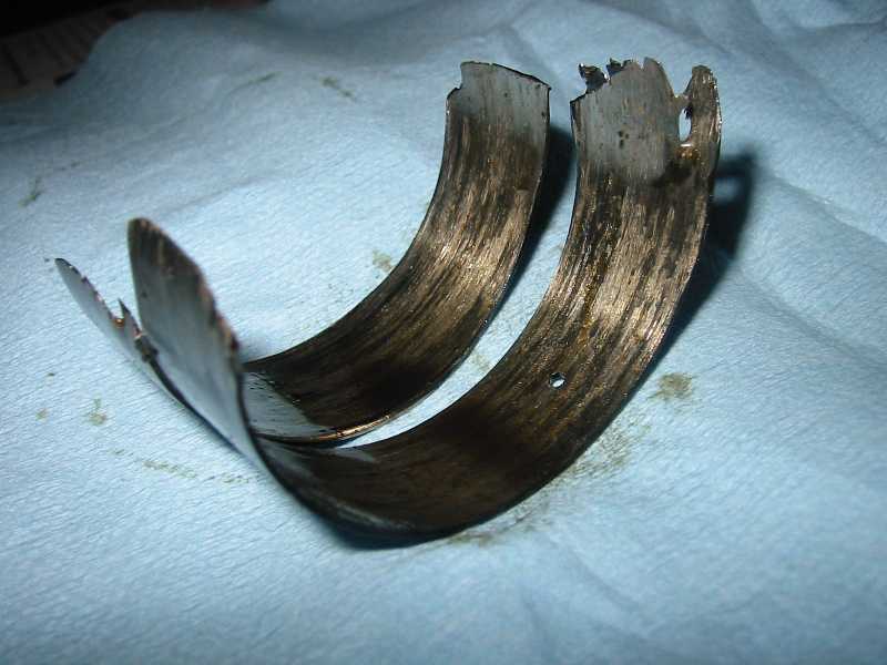

Spun bearing:
