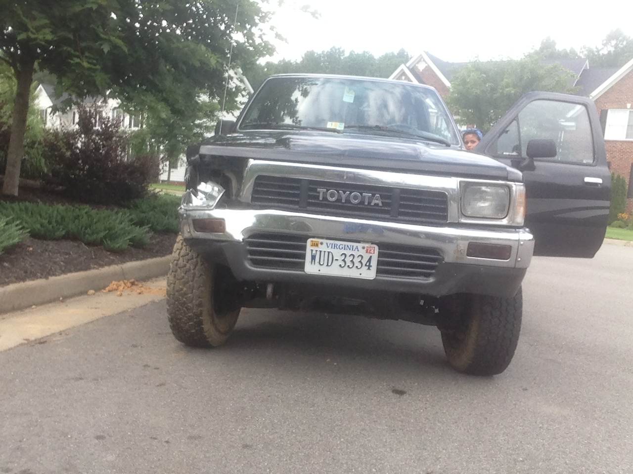

Hey y'all.
I'm new to the forums and I have a 1991 22RE which I am IN LOVE WITH.
I recently got into an accident (I rear-ended somebody on the highway).
The damage was on the front right end of the car, and I reckon I'll need a new headlight and quarter panel, but....
MY FRONT TIRES DON'T FACE IN THE SAME DIRECTION. The tires are off by seemingly more than 10 degrees, so I don't think I need a simple alignment.
I was hoping to diagnose my truck without a shop, but I'm having a hard time figuring out what is causing this steering issue.
Any advice would be greatly appreciated as far as how to diagnose my baby.
( I attached pictures )
Thanks!
Attached Thumbnails Truck Accident - Alignment Issues (ADVICE)-photo-6.jpg   Truck Accident - Alignment Issues (ADVICE)-photo-7.jpg

welcome to YT, sorry to see what happened to your rig!
i would get under the front end and take a look at everything. the IFS on a toyota is pretty much fully adjustable in terms of camber, caster, and toe. i would inspect to make sure nothing broke in the accident, so inspect all connections between parts. since i'm assuming you're saying your toe setting is off, i would look specifically at your tie rods and perhaps the control arm eccentric adjustment bolts area to see if anything is tweaked...well, it's most likely tweaked, just how badly is the question.
if the issue is just tie-rod related, it's a cheap simple fix. if the problem is control arm related then it's not so bad either - but if your problem lies in the crossmember/mounting points for the control arms, then you're SOL and the only real fix is to try and bend it back or chop it off and go solid axle swap. i would see what you can find on your own, replace the parts messed up, then take it for an alignment. i like firestone lifetime alignments since you can repeat visit without paying again - GREAT for IFS rig that either gets wheeled often or gets parts replaced!!!

That's a bent frame if I've ever seen one. And I've seen more than a few...

So I finally got my hands dirty today!
So proud of myself (The most work I've ever done to a car was brakes/rotors/calipers on my truck)
1) I replaced both tie rods (inner and outer for both) -- After adjusting them to the max, the tires were still cockeyed.
2) The spindle that the outer tie rod connects to was offset, so I hit it with an acetylene torch and bashed its brains in. This made the wheel start off in a straighter position before any tie rod adjusting.
3) My neighbor bent my rim back (it was in pretty grim shape) and my tire WASN'T EVEN DAMAGED. Reinflated it and good to go.
4) I took off my quarter panel and banged it out and spray painted it. It was a pain in the ass to get the mounting screws into the existing holes, but elbow grease did the trick.
With the new tie rods, the "heated up" "banged out" acetylene spindles, fixed tire and body work, you can barely tell the accident happened.
I just need a head light and I'm good to go.
PICS INCOMING SOON. (If anybody out there cares) haha
Thank you for your help!
