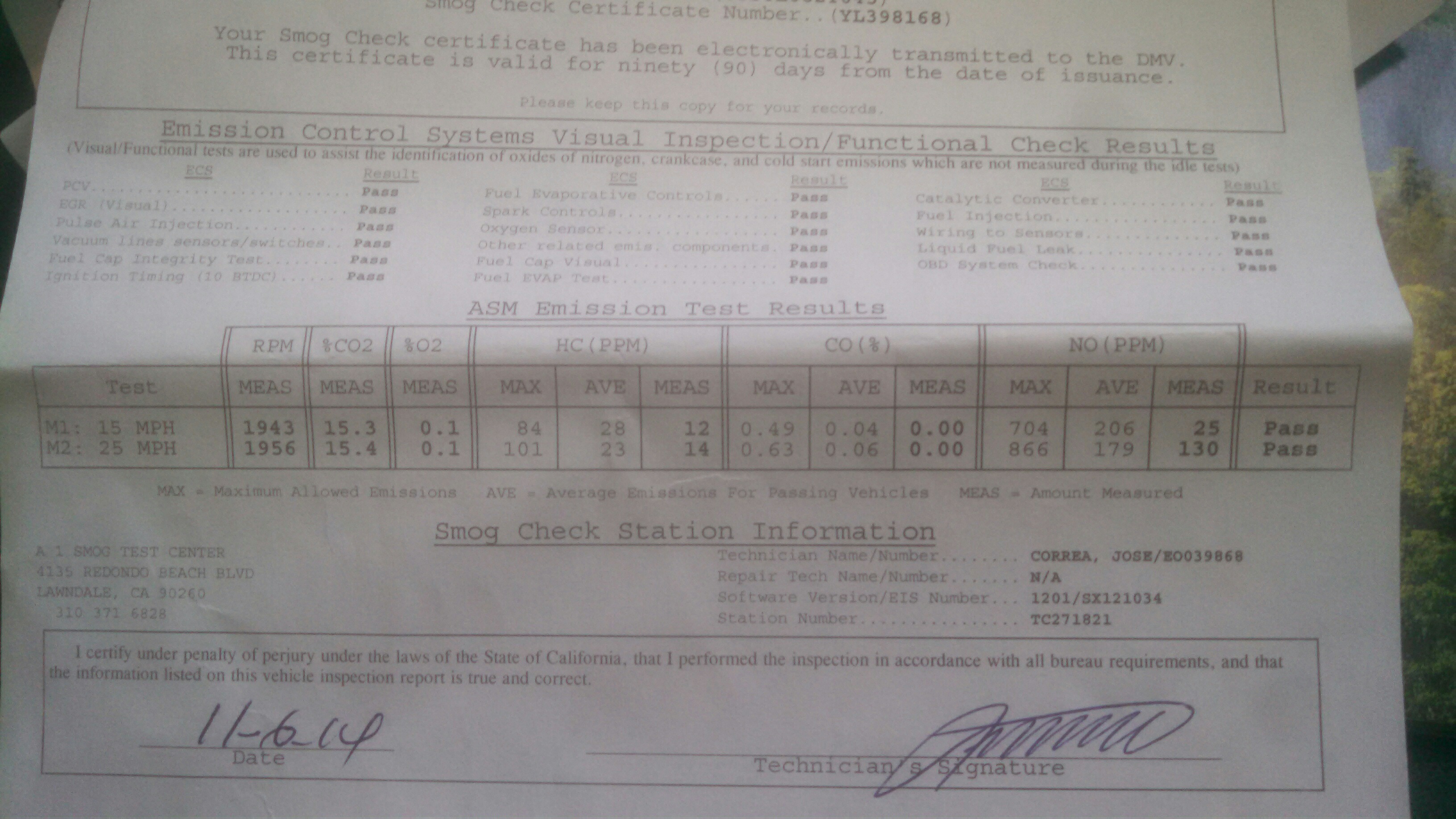

here is my smog results
Attached Thumbnails troubleshooting very poor mileage-img_20141231_141531_032.jpg

Jereli, your smog numbers indicate things are working pretty well when the ECU is running closed loop. Your 1.1V VF1 number also indicates that the ECU can control the mixture properly in closed loop mode, but the open loop tendency is toward rich. Not all that bad, though. Keep in mind, however, that smog measurements are made with the engine fully warmed up.
I suspect your problem is a combination of your short commute, meaning most of the time your engine is cold, and something not right in your cold-engine operation. When the engine is cold, it runs open loop; the oxygen sensor is ignored and the ECU estimates fuel mixture from the coolant temp, air temp, VAFM, and the TPS. If one of those sensors is giving bad data during cold operation, you could be running quite rich. Also check out the cold-start injector as I mentioned before.
