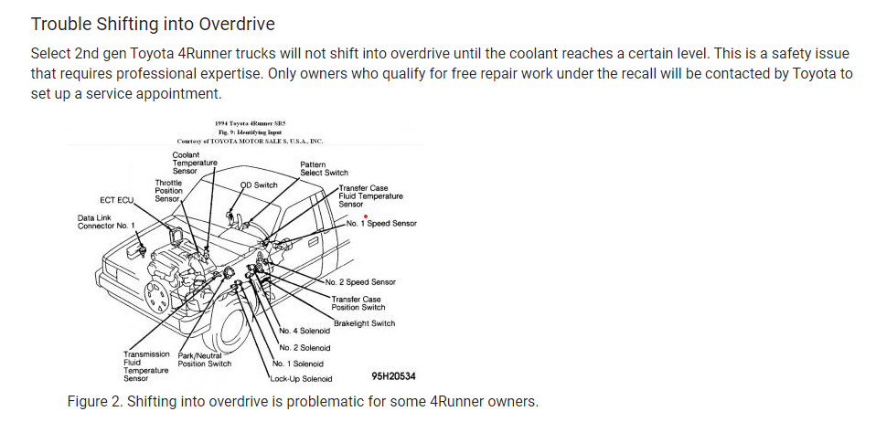

could it be this??

could it be this??
Yes.
Just to get the vocabulary right, you have a 3-speed plus overdrive (okay, that's really 4 speeds) transmission. The "5th" speed you think you have is lock-up. Lock-up can happen in 2 through o/d, but it's hard to notice it anywhere but in o/d.
So it's time to test your ECT sensor. Here's the page from the manual: http://web.archive.org/web/201311071...40engineco.pdf
[PS a bad ECT sensor could also contribute to high idle.]
