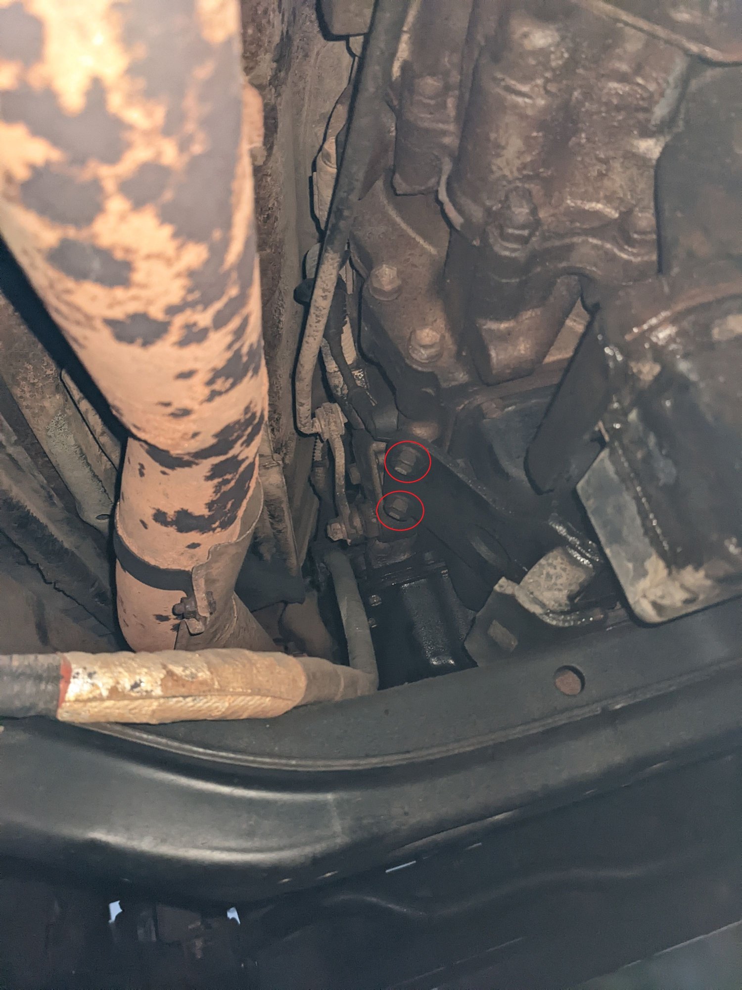

Chasing an oil leak in the transfer case area of my '94. One appears to be the transfer case output shaft seal. Looks pretty straight forward to replace. Another appears to be originating somewhere around the transfer case oil pan, but it appears to be sealed tight. The oil is dripping off of the mount though. I'm not sure if the shaft seal is the culprit for this as well, but it's forward of that. Question though... are the four bolts going into the transfer case from the mount exposed to the inside of the transfer case and therefore might be leaking?

No, those bolt holes would bottom out.

OK. Thanks. I'll start with the shaft seal and see what happens.
