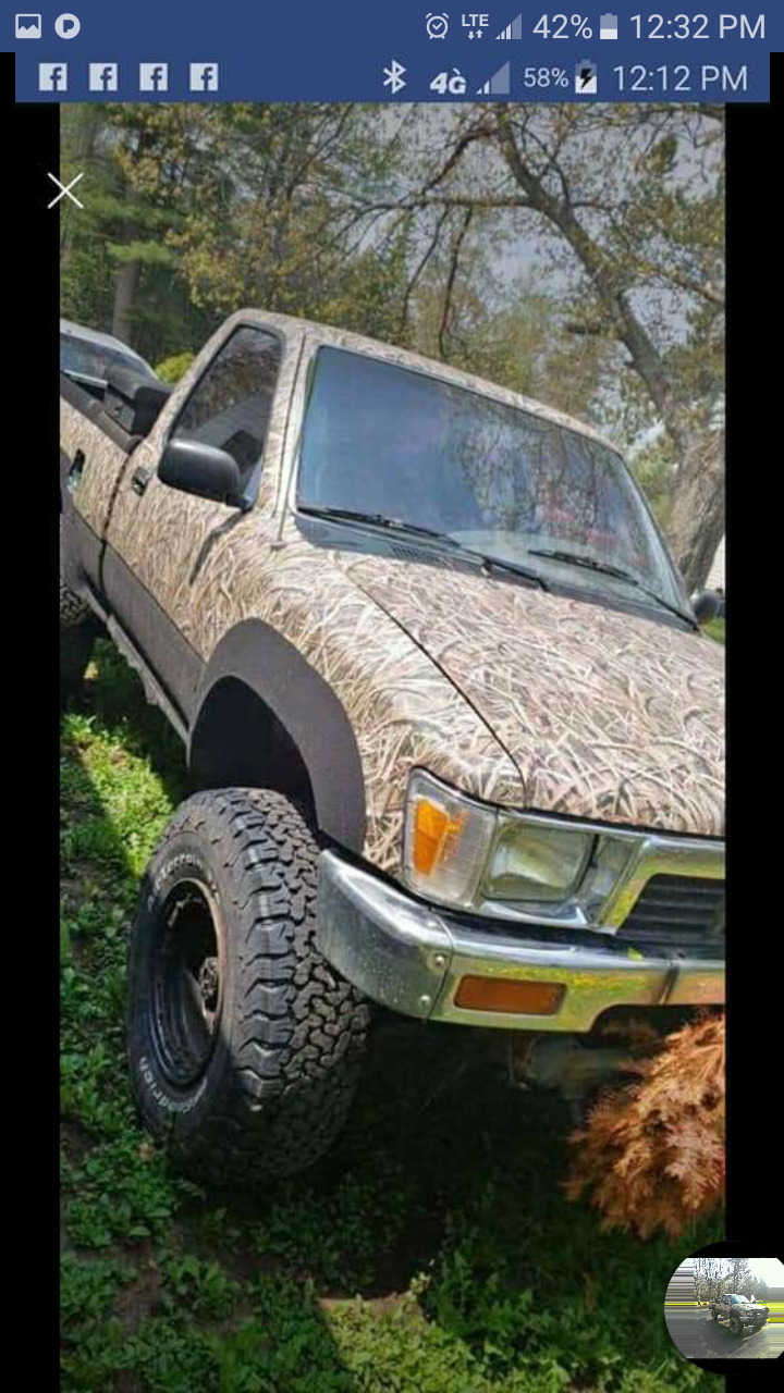

Alright folks new to the toyota world always been a chevy guy switched to a 90 5spd 4x4 pickup for a hunting truck 4th gear is wasted how do I tell what trans i have?? Any help is greatly appreciated
