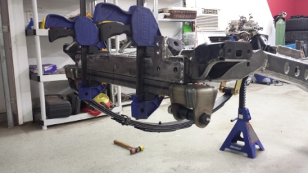

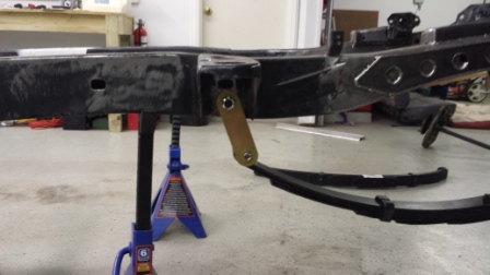

Hi Everyone,
I've recently begun to start on the SAS portion of my 94 Toyota pickup rebuild and wanted to ask what people think of my current shackle angle. I currently have the all pro spring hanger and 4" trail gear springs. Right now everything is off the truck so its pretty much frame only. I've posted a few pictures of the shackle angle and front spring hanger. Currently I have the spring hanger flush with the front of the frame and only mocked up with clamps so its easy to move around.
Thanks everyone

Looks like it would be good once there is weight on the springs

Just a suggestion, just tack it for now until you get the engine/cab etc on it.
If shackle angle looks ok after all the weight are on the springs than burn it in...

The plan is to tack in place for now until I get more weight on it. From the other pictures I've seen this looks very similar to others. I was expecting to have the hanger forward a touch with the 4" spings but maybe not. Thanks for the replys

Went ahead and tacked the front hanger into place flush with the front of the frame. Will be awhile before I get weight on it but at least I feel like it will easy to adjust later on if the final shackle angle is not to my liking
