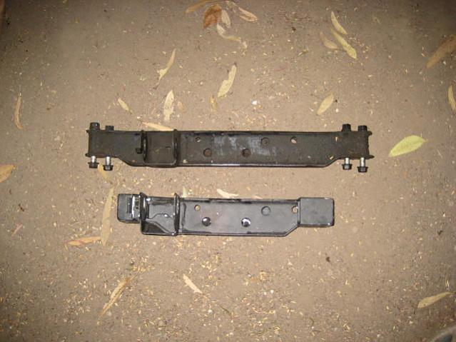

Here is a side by side of the stock CV vrs. the T-100 and a picture of the front diff crossmembers.

Originally Posted by AZkid
wait a second, if the t-100 a arms are the same, but wider, wouldnt it mount up to lets say a 4-runner and be long travel in a sort of way?
The A-Arms are not longer. The axles are longer on the T-100's because the frame is wider than the truck/4Runner, but the front carrier is not proportionally wider. The axles make up the difference.
sio the a arms are no wider then a 4 runners? just for clairification
Affirmative.
