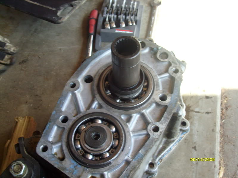

Whenever flat towing or using a tow dolley for a Toyota 4wd remove the rear drive shaft. That is straight from Marlin at Marlin Crawler. I wish i had taken 5 minutes for 4 bolts whwn using a tow dolley for a short distance. Somehow the truck went into gear and i destroyed a transmission.

Most of those smaller vehicles are ok to flat tow.
feel free to flat tow your toyota 4x4 all you want despite recommendations to spend 5 minutes to undo 4 bolts.
From my personal experience i will pull the rear shaft.
It was an expensive lesson

Originally Posted by ColoradoToy91
Flat Towing a Toyota <-- Must disconnect rear driveline!
Quote:
Originally Posted by Marlin Crawler
On all auto chain driven and manual gear driven t/cases, if it is towed in two wheel drive, the output shaft will turn, but there will be no way for the oil at the bottom of the case to get to the top where the output shaft is. On the chain driven cases, the input shaft turns the planetary housing which drives the oil pump. Gear driven cases use the input gear and low range gears to throw oil on the inside of the housing that collects the oil via gutters and directs it to the rear of the case by gravity. Both style of cases, must have the input shaft spinning to lube the output shaft, speedo gears, and rear seal of the t/case. The rear driveshaft must be removed.
Marlin
