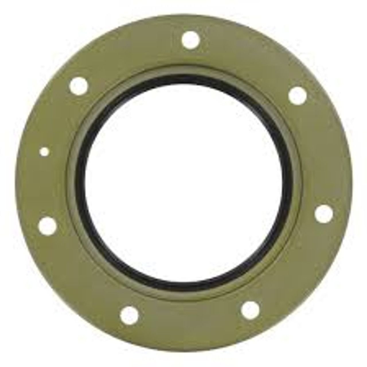

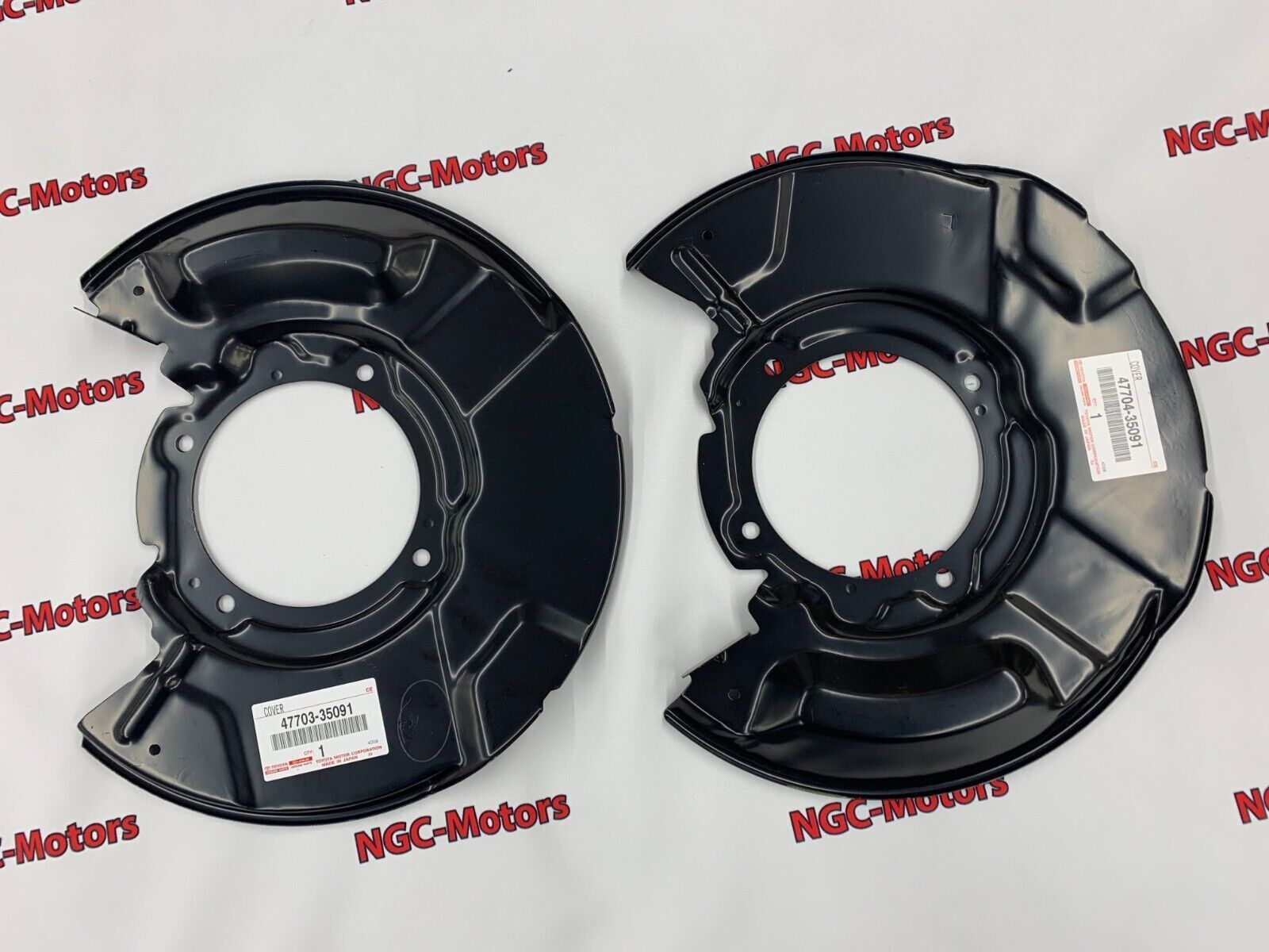

Is the torque for the bolts (7) that secures the dust oil seal to the dust shield/cover 34 ft. lbs? I used a torque wrench set to 34 ft. lbs which resulted in the bolt breaking when torquing. Now, I'm hesitant to torque the rest of the bolts for fear of breaking them.

If I am reading the FSM correctly here, it says 13ft lbs for the dust cover bolts

Which is low enough that i wouldn’t spend the time getting out the torque wrench. Just “pretty tight” with a 3/8 ratchet and one hand.
