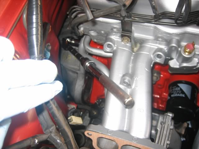

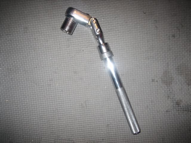

I used this type of wrench
Driver's side

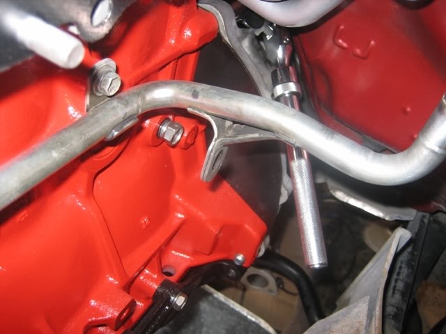

Passenger side

Originally Posted by Grego92
[/URL]
Ah, gee, Grego92. Couldn't you have cleaned up your engine compartment a bit before taking pictures?
LOL. Show off!

That was a Husky 3/8" extendable flex-head ratcheting socket wrench.
Snobbs idea of a flex-head wrench is good too, maybe a large diameter pipe to go over it if you need some leverage or just longer so you don't have to reach down as far while ratcheting.
Nothingbetter's idea of removing the mounts to get some more space is a good idea to keep in mind.
