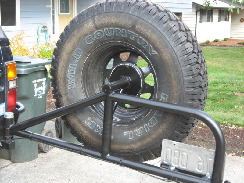

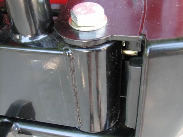

4crawler's bumper:
if you are considering having a gas can too (that is a ton of weight) i would make it double shear like 4crawler's.

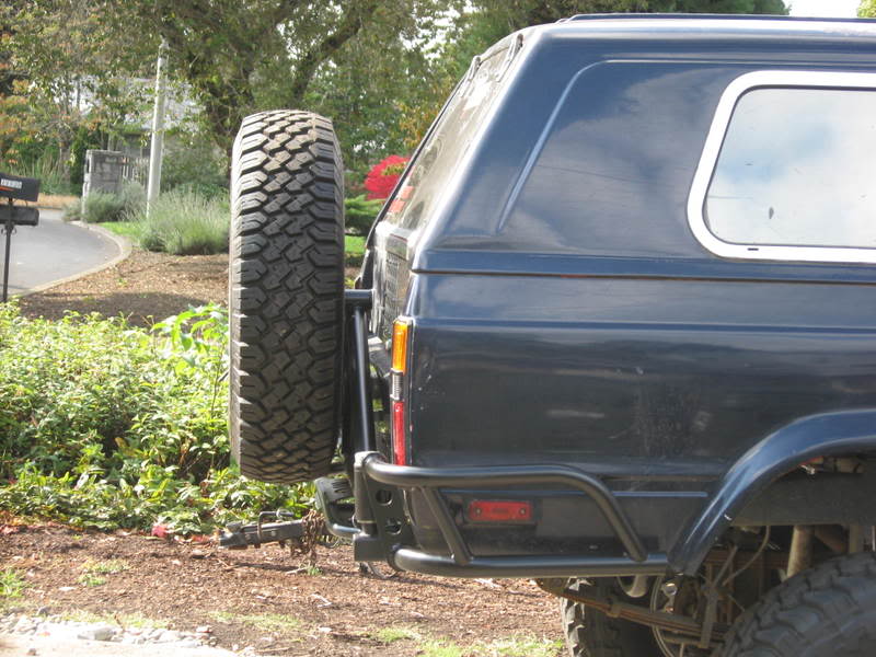

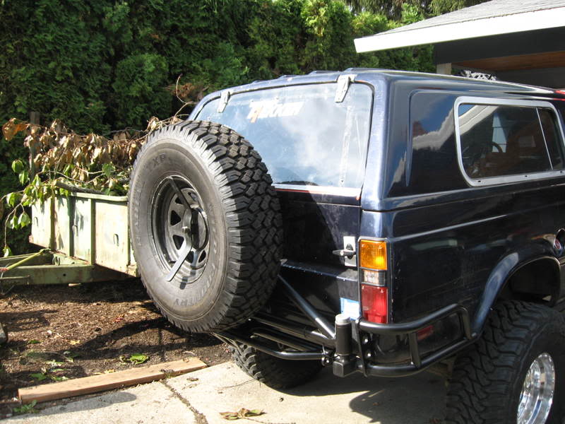

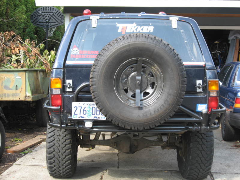

My Marlin converted to rear swing out:
i have since cut it off because of the trailer axle used has a pivot was not that strong and I had heard of some failures
