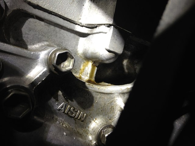

i did a seach but couldnt find anything like this??? have you guys seen this before? 22re timing chain cover cracked this way. what would cause this? can you see oil leaking from below the round area of cover.

looks like someone tried to pull the head without removeing the secret bolt in the puddle of oil.

aaahhh...just saw youtube video with the bolt you are reffering to..so how big a job is it to replace this? can i still find new aisin cover for it? looks like a big job! if i took it to a mechanic what would be a fair price to fix this? any additional info would be apperciated.

when my old 20r had a crack there, it would leak out the oil under the dizzy. i pulled the dizzy and the bolt, covered the bolt in grey permatex and torqued it back down. it never leaked afterwards and i never had to replace the timing cover

The other possibility is that the bolt was over-torqued upon installation (ask me how I know). Mine was a brand new cover and the crack was clean. I prep'd the crack and JB Welded it . 2 years later and still no leaks. Its the only thing I've half-assed on this truck and so far so good.

May be a couple weeks before i can buy cover... So i can permatex the bolt inside under valve cover or i can jb weld the crack from outside right?. I may have to do that for a temp fix.

I cleaned the outside surface with brake cleaner then applied the JB weld. It was meant as a temporary fix too, but like I said, two years later...
