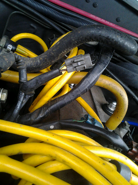

I checked the ECT wiring and everything checks out good. My test shows that the coolant temp sensor is good. My check engine light comes on when it's unplugged. I noticed the EGR gas temp sensor also shares this same brown/black wire and has been unplugged, but that is the ground so it shouldn't affect the TPS not working. I'd like to plug it in just to check but I can't find the connection for the life of me! I did find out that the green/yellow wire going to my TPS only has 6 volts. Is this normal or should it be 12?
Can anybody help this little bastard find his home?
Old Mar 11, 2013 | 03:44 PM
Co_94_PU's Avatar
iTrader: (-1)
Joined: Dec 2012
Posts: 5,433
Likes: 555
From: Colorado
Yeah E2 is shared by all(or almost all) the sensors, it actually routes thru the ECU to get that ground to the body.
Can you wipe that off and get the wire colors. It's a semi generic 2wire plug, vac-switch most likely assuming your EGR temp wire is connected.
And after a quick reread of the thread, I see your EGR temp isn't plugged in that's likely it right shape right location. BR-B and G-W are the wire colors. G-W goes to I think pin 13 on the ECU, didn't dig out the other wiring diagrams, it's right next to IDL.
G-Y is VCC should be 4.5-5.5.
My wild guess is... Intake manifold ground strap, clean firm and not overly frayed?
