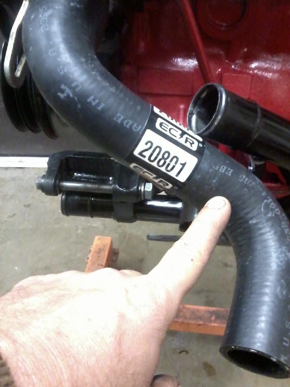

You did not mention which motor you have but if it is the 22r motor, another common problem I find is the hose that connects to the horse shoe pipe from the water pump. They tend to get neglected. Because it is so close to the alternator, I disconnect the battery when working on this hose and also cover the hose clamp with electrical tape when installing.
Copied...
Parts store will tell you this is a dealer item or they do not stock it. This hose likes to leak coming off of the water pump or pops a hole. Gates PN#20801, just cut off where my finger is at. A lot cheaper then the dealer.
