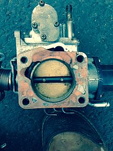

tb gasket
having a hard time finding the correct gasket for this anybody have idea where i can pick one up from.everything i find seems to not look anything remotely close to how this gasket was tb gasket-fcidv3x.jpg 89 4runner 4cycl 22re auto

My guess is FEL-PRO Part # 60876 . RockAuto has them for $1.13.
Of course, I'll bet you'll have an easier time finding one if you knew what make-model-year-engine you had. I can only guess it's a Toyota pickup 22re, and I have no idea what year.

89 4runner 4cycl 22re auto sorry bout that

I've not had any issues finding gaskets at my local Napa store (except for Cold injector gasket).

advance auto FEL-PRP 60675, just picked one up for my '89. they had to order it , got it the next day

You could always use gasket material. Just put the material over the tb and press on all the holes and they will leave indentions
Then simply cut them out with a razor blade and some scissors.
A huge roll is cheap and makes ALOT of gaskets.
