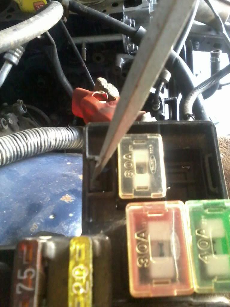

Just adding this for the next guy, it threw me for a loop trying to figure out how to get it out the first time.
All of the other fuses lift up and out. The 80 Amp you have to pry this tab to the firewall and push out the bottom.

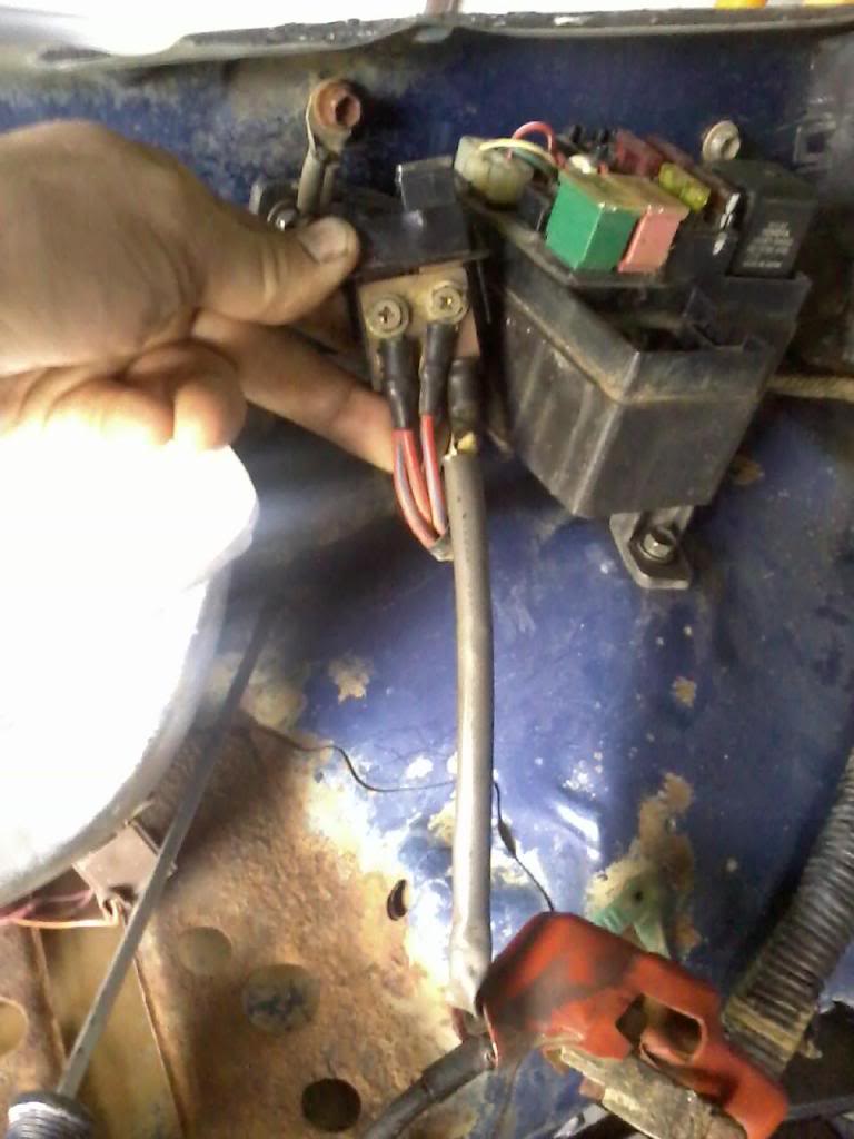

Here it is mounted to the Fuse. It mounts behind the wires. I usually have to take a 8mm socket to the screws the first time. They can be TIGHT.
