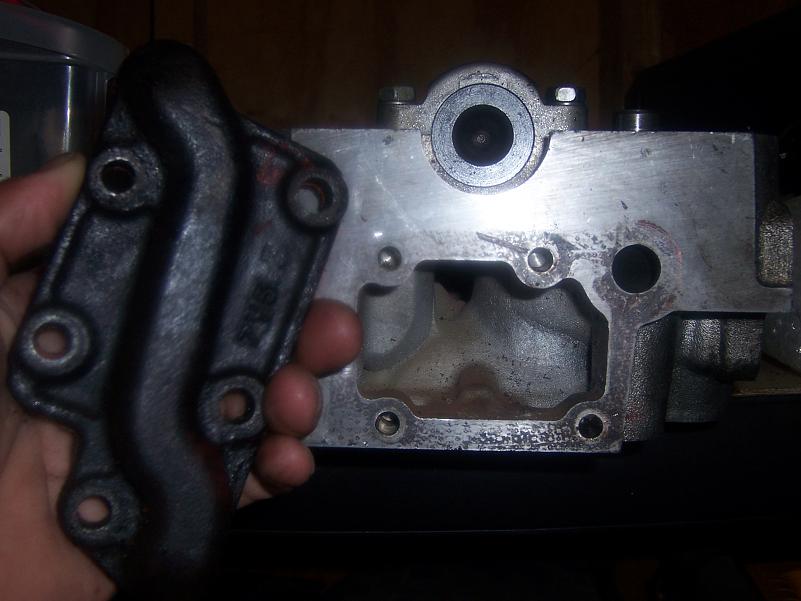

I started a new thread askin for help on this, but does anyone know if this could be causing my leak? And what is it?
Right above the clutch etc...

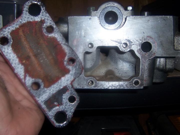

Hey man that plate has coolant running thru it not oil , your leak looks like its coming from the valve cover or the half moon . which is better for you because its easier to fix than that plate . I think ..

I'm pretty sure you are both wrong. There is exhaust gas going through that plate on its way to the EGR, and coolant on the back side of the plate.

well thats what I meant .
any way here are some pics I just took

So, to fix the valve cover leak, just take off the valve cover and put a new gasket on it? Easy as that? And what is a "half moon"?

Well, I think I'm right, but I should have been more clear by saying I also believe the oil leak is coming from the half moon on the valve cover. Nothing wrong with a little constructive criticism though.
The "half moon" we are referring to is the rubber piece that goes between the valve cover gasket and the head on the back side. There's also one in front so you can see what we are talking about. And, yes, pull the valve cover, then reseal or replace that piece and you should be good to go.
