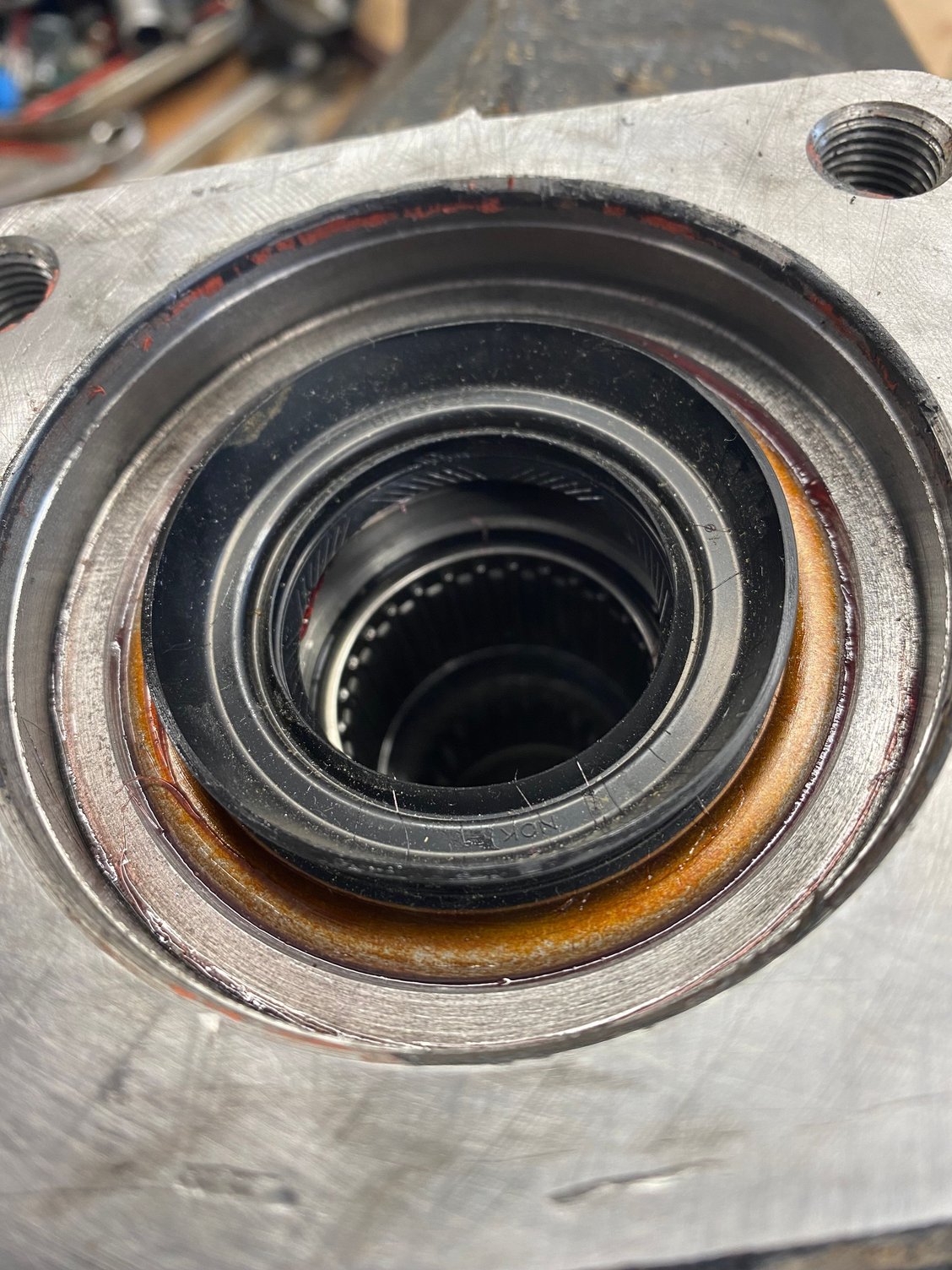

I’ve been reading all about this, and really glad you posted this pic, it tied things together for me I think- would be nice to get someone to confirm. This is my interpretation of the steps for eliminating the add.
1. Remove add differential (in my case 4 cyl. 7.5” ifs add differential) from vehicle.
2. Remove add “axle tube” from carrier
3. Once the add axle tube is removed there will be a small gear looking thing left in the carrier where you just separated the axle tube from the carrier- that is part of the old add system- basically it’s the part that will engage or disengage when the add shift fork slides over to make 4wd active- that gear needs to be removed, leaving you with the condition shown in the picture above.
4. Install the required seal that zuk mentions on his site (you can buy it from dealerships or yota shop.com)into the void shown in picture above.
5. Bolt on non add axle tube to carrier
please update/correct this if you have actually performed the operation. I’m still confused why people say you can just pry that small gear out of the carrier- they specifically say there’s a snap ring on the inside- if you pry it out did you just release a snap ring to be ground up in your carrier? Seems like removing cover, removing snap ring, and then prying out with bars/screwdriver would be the right way.

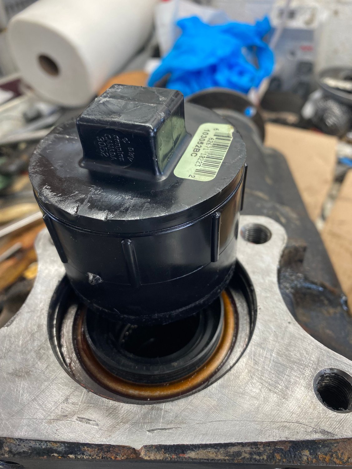

Posts: 8
Pic shows axle stub pulled, new seal installed, seal and clip part numbers, and 2” pvc coupler used to drive in new seal

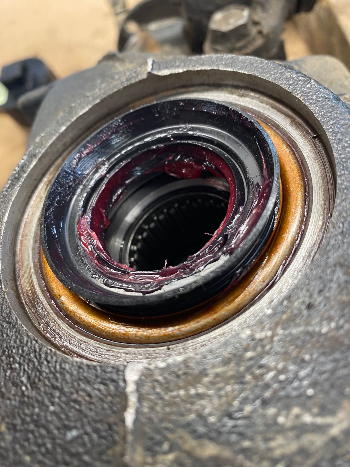

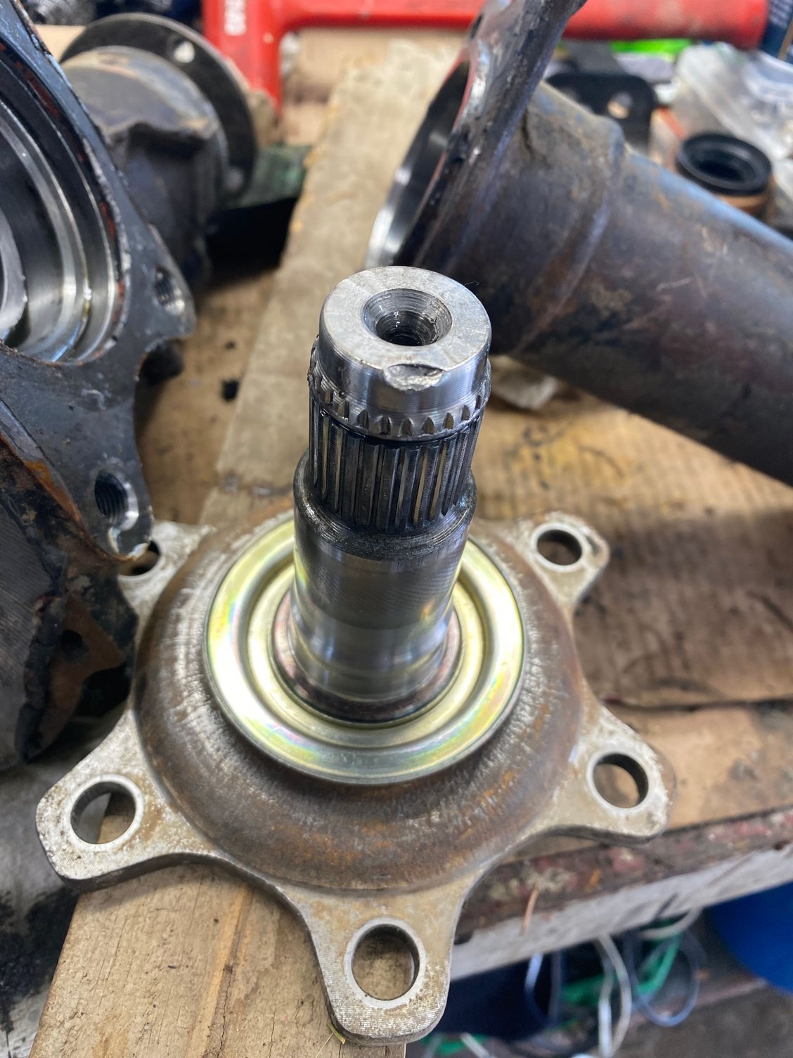

From: Yellowknife, NWT, Canada
Soooo got into this today and had enough QA issues that prompted me to remove diff. Loose fasteners, noticed both seals weeping.
- I had a Spartan locker installed and really never drove it since due to turbo installation and standalone project that took some time to sort.
- CV flanges just better than finger tight.
- stub shaft end damaged (dropped?) will stone it and reinstall. No steel found in case.
- long shaft has witness marks from lock pin on end.
- needle bearing cage damaged, took a punch and nudged it true, roller bearing turns with no issue.
- bolts on flange holding axle tube were loose.
- there was NO seal installed after ADD was changed out, axle tube was full of oil.
