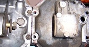

Originally Posted by Fernley1
Here is another item I found when I did my ADD to non ADD swap. The axle cover where the oil fill plug is was different between the two covers. The non ADD cover has a lower fill plug level then the ADD cover. I think this is becouse on the ADD axle, the oil has to get to the ADD connector, with out ADD, it is at a lower level. I did swap the cover so that the level will be right.
Hmm interesting. I'll have to keep an eye out for that too.

Here is a pic I took. The cover on the right is the ADD one. note that the fill plug is a little higher.
Attached Thumbnails swapping non ADD tube to ADD diff. Searched and now confused-picture-001.jpg

Now that I think about, not so sure that little bit of level change is going to matter.
Remember, it's pretty much the same third with the same gear set in it.

No, wont matter. Just some info to pass along. The lower fill plug position helps the gear oil stay out of the long tube. Before I swapped covers, I filled the axle about 1/2 inch below the fill plug,
