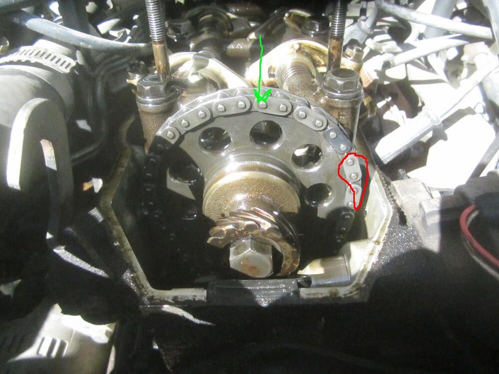

Snow finally stopped, so I got out and pulled the valve cover yesterday. It does look like it jumped the timing, unless I misunderstood the manual. At TDC, the two bright links on the chain (circled in red) should be at the top, where the (badly drawn) green arrow arrow is, no?

I don't think you are at TDC, for a couple reasons. First, I think the bright link(s) lining up with the mark on the gear is only when first installing, after some rotations I don't know that the link lines up again. But second thing, there is a timing mark on that distributor gear there at the very front of your engine. I don't see the timing mark, so I think you need to rotate around another 180 degrees and see if that timing mark comes to the top. And then look at your rotor under the dist cap and see that it should be pointing pretty close to #1 plug.
You're right. (Kicking myself for not thinking of it.) It does seem the timing is right: with the crank at the TDC mark, the cam mark is at the top and rotor at the #1 plug. So that rules out timing as the cause, I think.
