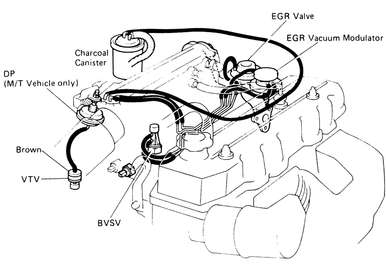

Old Mar 3, 2015 | 07:39 PM
Terrys87's Avatar
Posts: 11,787
Likes: 28
From: Anderson Missouri
Closest diagram I can find. Dont think it has all of them, missing the VSV hoses.
