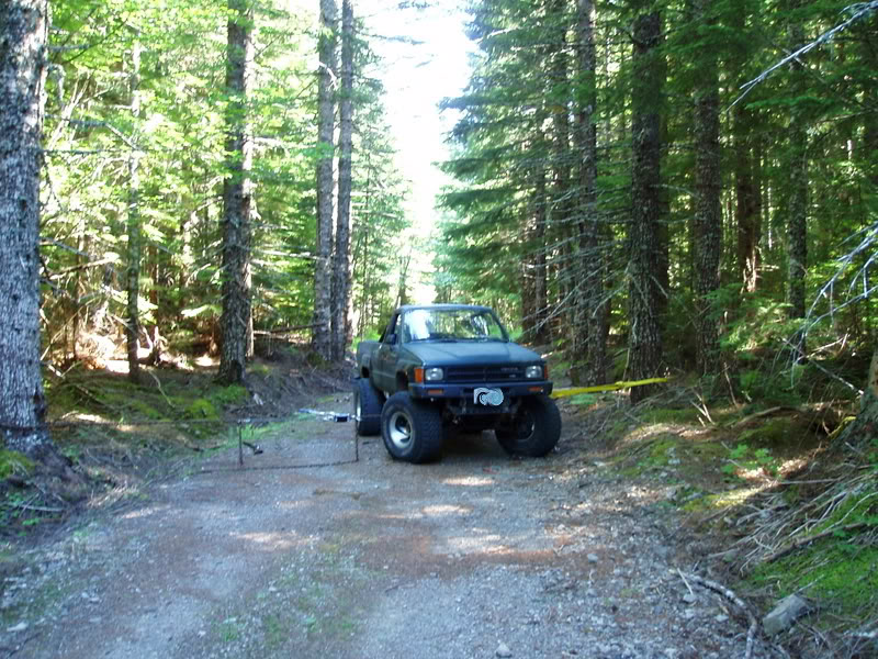

Originally Posted by Jay351
I have heard of people straightening a slight bend with a tree and a comealong. I guess it depends how bad it is.
Mine took 2 trees and some considerable effort with a 10,000 lb. rated come-along, it was bent "bad" IMO. Needed pulled out just about an inch, which don't sound like much, but trust me it is. 2 words, box frame. You'll have a real good idea how much force it takes to bend one once you reef down super-tight on that come-along, stop and check the frame and see it hasn't budged more than a millimeter. Bigtime backache lemme tell ya. But done is done, as I always say.
And now I got the vaccine for that, The Sonoran Steel Early IFS Truss.
