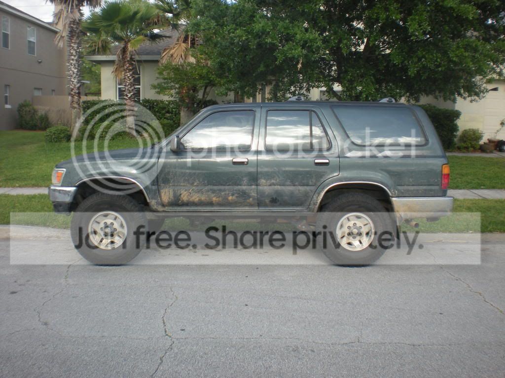

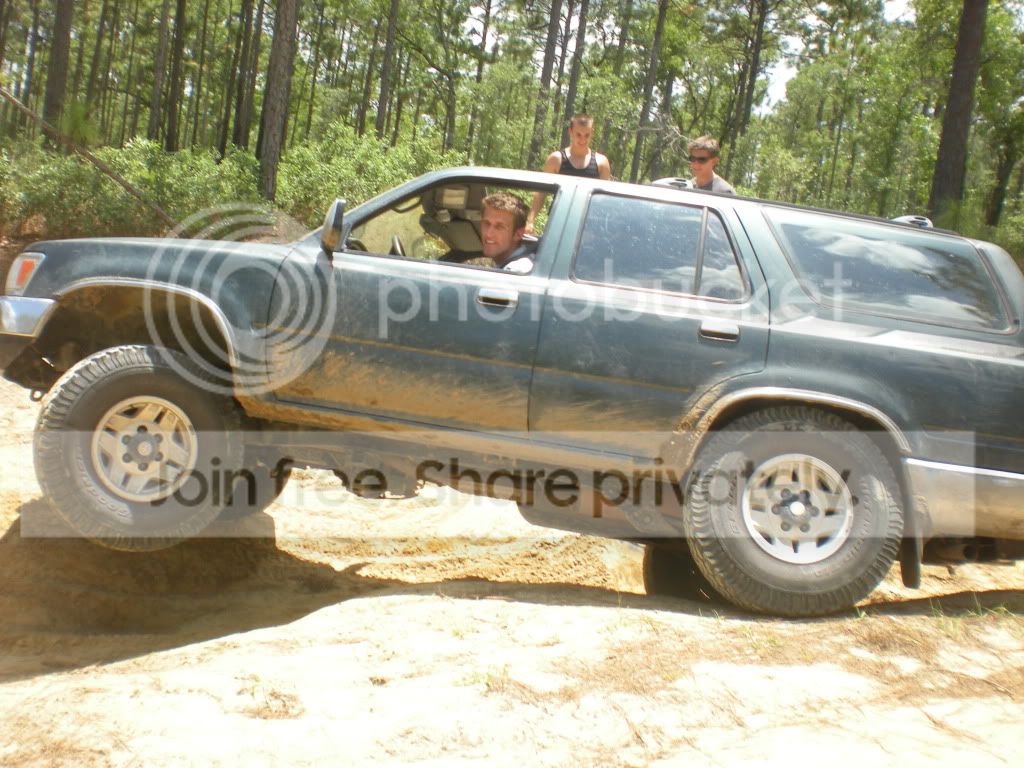

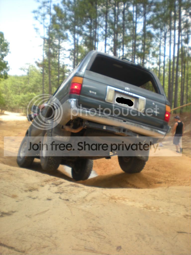

Hey Fellas. Just put some 33/10.5/r15 BFG All-Terrains on my 4runner. The only mod I have is a 1 in. leveling spacer in the rear coil springs but other thatn that the suspention is stock. I also took it wheelin and was suprised when I had NO rub. Here are some pics. I also wanted to see any other 4runners out there that did the same thing.

Haha really? I have searched forums and have only seen a few. Well I feel dumb I would think people would do it more because of how well it works.

Well I noticed a bit of a drop in mileage but my power wasn't too bad. To be honest it felt almost the same as before.

Almost everyone who lifts their vehicle is doing it to clear bigger tires. To be running 33" tires on a stock 2gen 4Runner with no rub amazes me. I rub my 31's sometimes off-road. 33's would require some trimming/hammering unless you're running some magical offset?
Well the older 4runners/trucks have a ton of space to fill. What year is your vehicle?

haha oops after I wrote that I saw you also have a '93 and Im surprised you rub with only 31s. Before when i was wheelin 31s I NEVER rubbed at all!

To "mall crawl" with larger tires it does. I'm guessing you have an older 4Runner? No way you would be doing any kind of wheeling on a stock 2gen with 33's and no rubbing.....without trimming/hammering of course.

Yep, you got me. No way is this my stock height 4Runner with 33x10.50 BFG A/T 'wheeling Saturday.
