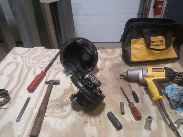

I got my spool the other week after welding it became too much of a challenge.
Heres the 3rd with stock spider gears.
New spool ready for duty
Carrier out, bearings and ring gear removed. Any one want a 4pinion carrier for a v6 toyota 3rd? Sell it to you cheap
ring gear pulled, bearing being pulled in this picture
and on to the spool.
The bearings went back onto the spool then into the 3rd.
Checking backlash
and the completed 3rd ready to go back in some time next week when i can get my truck in the garage.

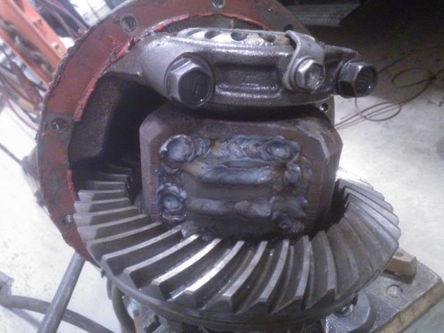

And Im running welded 4cly diffs in my truck. One is a locker that the teeth were skipping and worn so I welded it up too. If you want them to hold up, weld the gears TO the carrier.
Heres the welded locker. haha.
