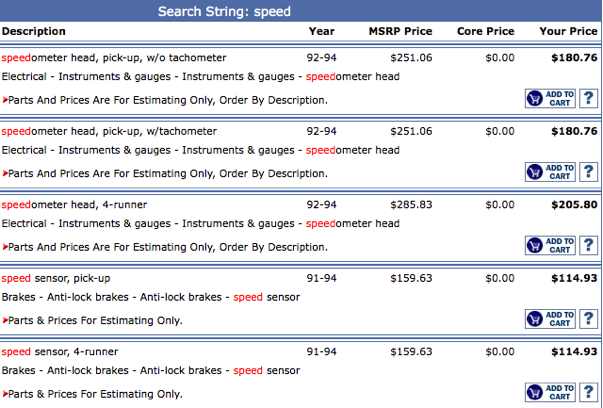

OK, so you don't think I might need one of these parts?

thanks scope103 for your post. sorry for the late reply. I wanted to check on part number 83181-35050 for the manual transmission 2nd gen (1992) 4runner SENSOR, SPEEDOMOTER (the one that may fix the speedo issue). I checked the part number, it's definitely a speedo sensor but it's listed for the 1994 previa on 1sttoyotaparts.com and I wanted to make sure. The part there costs $168 with a hefty $231 list. Does that sound right? The other part I found is called SPEED SENSOR and it costs less, is in the brakes section, and costs $116 with a list of $159. Since these are definitely 2 different parts I wanted to make sure. Thanks again scope
Electrical - Instruments & gauges - Speedometer sensor
Speedometer sensor, previa, 4wd 1994
