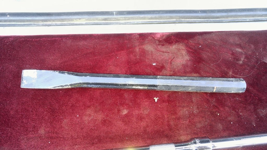

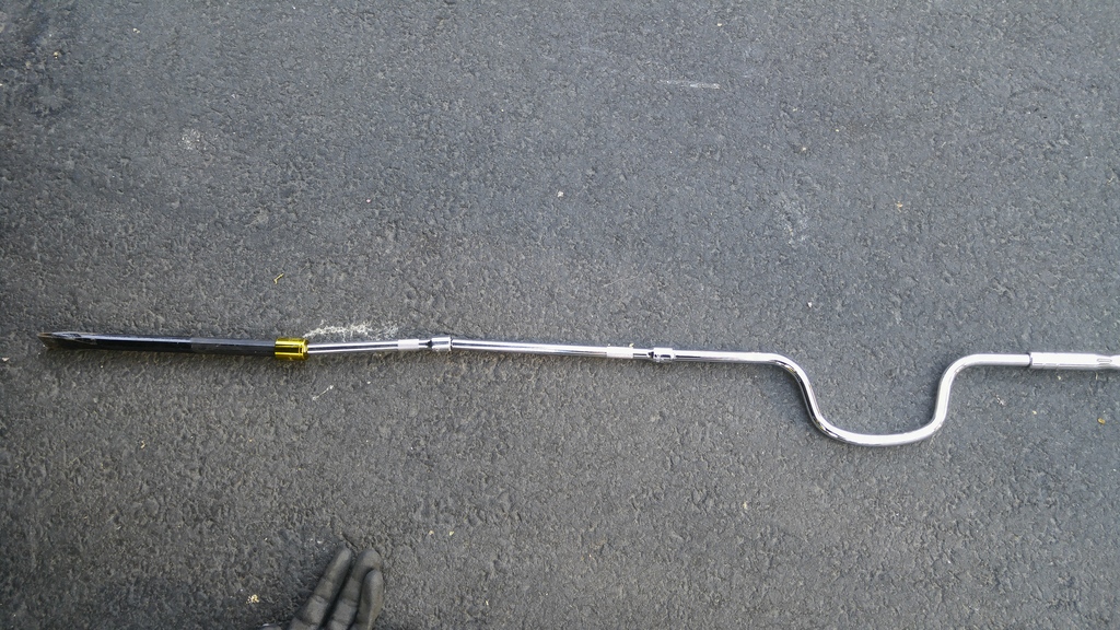

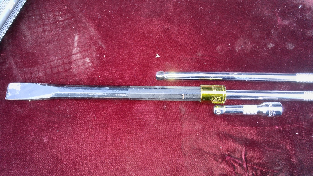

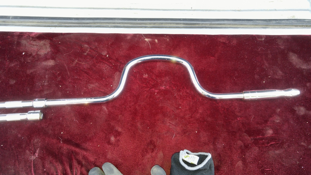

I had no tools and I didnt want to pay more than $60 for them, so I made a spare tire removal tool out of stuff from Harbor Freight. Took me about 5 minutes due to the chisel falling out of the slot. bigger chisel might help.
this fit in a 16mm socket
