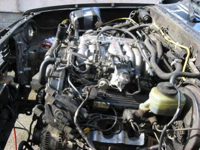

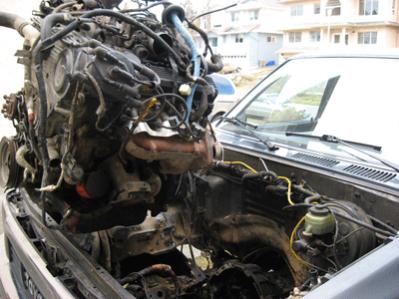

I had to replace the aging 3.0 I had in my pickup this weekend. I has survived 555k km's and an engine compartment fire. The top end finally decided to go, and I decided it was time for a new motor. I found a good deal on a fully rebuilt 3.0 and talked to my mechanic about putting it in and he wanted $1000 to pull the old one and swap in the new one.
I decided i have some time off right now so I will give this a go on my own. I have never undertaken anything even close to as involved as this, but i figured it is just plug and play right?
It took about 18hours total, and i did it all in my landlords driveway (very cool of them to let me do that!) So i am posting this thread for anyone out there thinking about doing this swap on their own who isn't sure if they can do it.
I had to reuse my old wiring harness bc the new motor was from an automatic. I decided to pull my old motor wiring harness intact and swap them out on the ground to make it easier. I removed the hood, radiator, fan, battery, alt, and detached the PS pump and put it off to the side where the battery was.
Then i pulled every wire and hose that attached the engine to anything else in the engine bay. On the passengers side fender well there is a little junction box of vacum lines and wires, i unbolted that from the body and pullded that out with the motor in one piece.
I undid all the bellhousing bolts. They were kind of a bitch but I was really glad i have a 3" body lift to get those top ones out. I thought I had them all but the starter has a bolt at the top from the otherside that holds it ot the bellhousing.
I had a hell of a time pulling the engine and tranny apart so i wrapped a chain around the front of the motor and hooked the winch up to it. Worked like a charm. I accidentally disloged the clutch release lever. I don't recomend removing or touching that unit at all. For some reason i thought i had to remove it, you don't.
So i hooked the chains up and hauled her out of there. It was a sad state. Oil leaking from several locations, charred from the fire and very dirty. I removed the throttle position sensor so I didn't crush it with the chain. I just took it slow and was carefull not to crush anything.
Attached Thumbnails So I swapped in a rebuilt 3.0 this weekend-scorched.jpg   So I swapped in a rebuilt 3.0 this weekend-winch.gif   So I swapped in a rebuilt 3.0 this weekend-pulled.jpg
