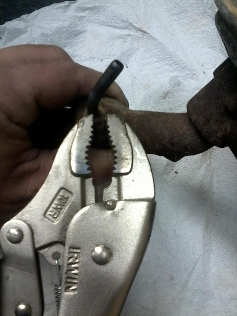

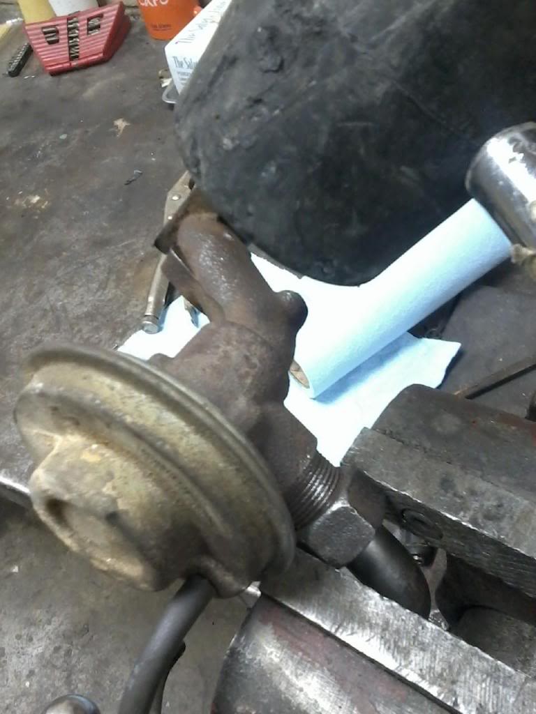

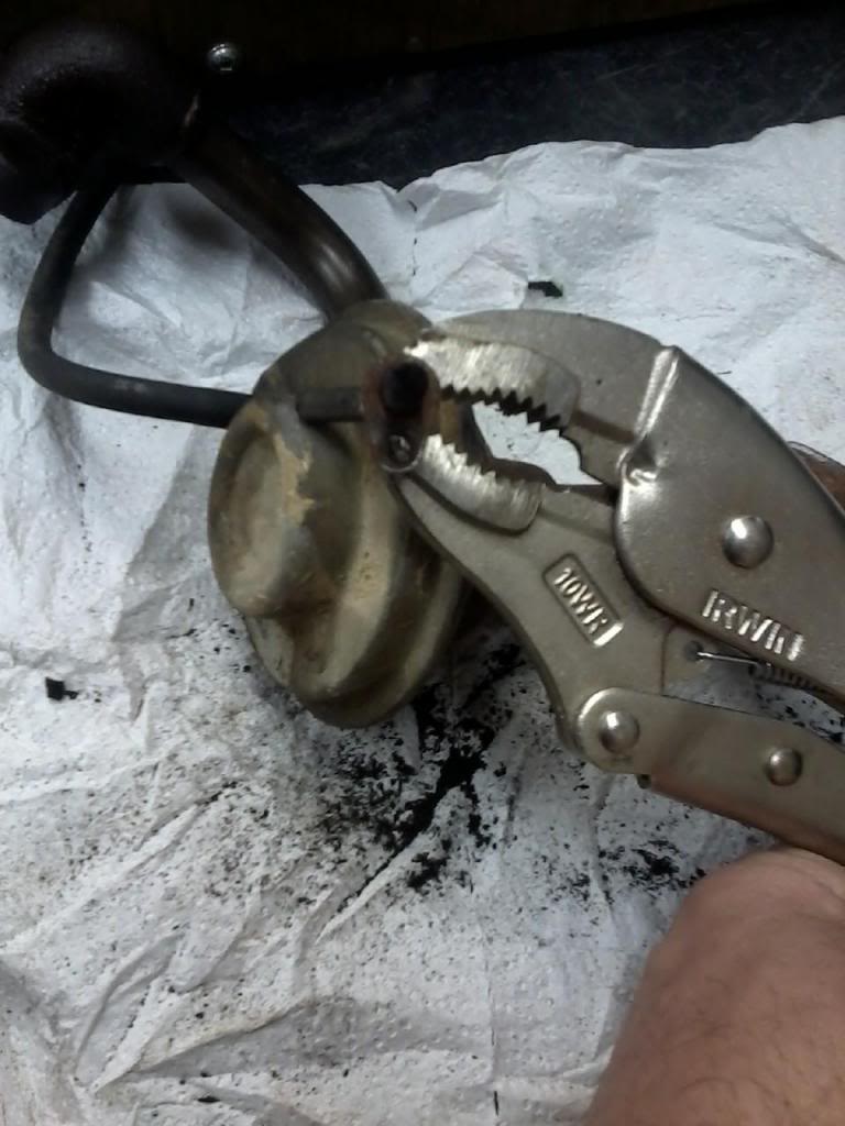

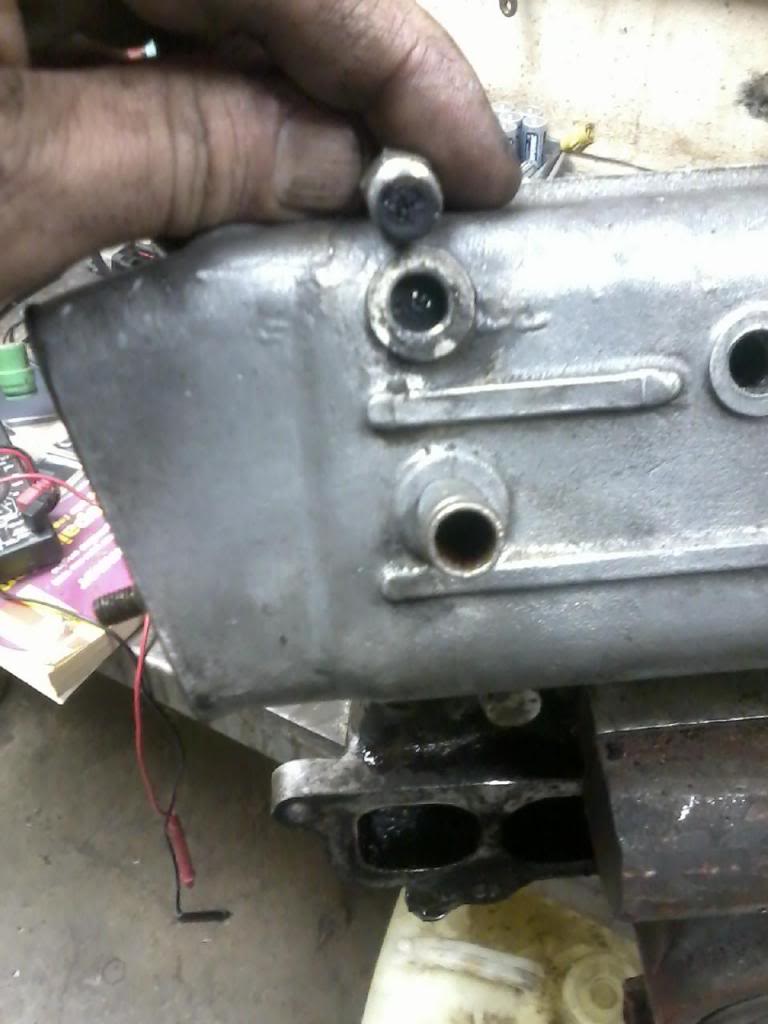

I have gotten several EGRs working. The carbon can get rock hard. I am not familiar with the 3.0 EGR but it is similar to the 22re. I feel you may need to pull the plenum as well and give it a good cleaning. All of the tubes will likely be clogged as well. The tube on the EGR and inside the EGR will have alot of carbon.
Here is how I clean mine.
Copied...
I worked on the EGR. Here is another picture that may look like the wrong way to do this, but the screw will strip if you use a screwdriver. Get a good firm grip, but not so hard to distort the screw.
With the screw out, get another bite on the the pipe to get it out of the EGR. Leave the carbon in the pipe at this time as it will help keep the pipe round. The carbon is hard as concrete. Slowly work back and forth to get the pipe spinning inside the EGR tube and to start breaking it free. Could take up to 10 minutes but just be patient.
Once you get the little pipe out, I tap on the the big nut with a wrench to help break the rust up on the threads. The I mount the nut in a vise and tap in both directions, tightening and loosening, with a rubber hammer. I have tried using wrenches and did snap an EGRs threads one time which ruined it. These run about $150 on ebay if I recall right. This could take another 10 minutes.
After it is apart, I use a drill bit, screw driver, nail, clothes hanger to get all of the carbon out. It is rock solid in places. You can put vacuum on the hose and see and hear the plunger moving and operating inside the EGR, the goldish part.
It is clean and working but didnt get any pics.
Here is one of the metal pipes that was clogged. The carbon gets hard as a rock. I use a drill bit with my fingers to help break it loose. The carbon on my finger is only half what came out of the pipe.
This is the same port that was clogged. The rest were clogged just as well. This is normal as to what you are going to find on a 150k mile or more trucks.
