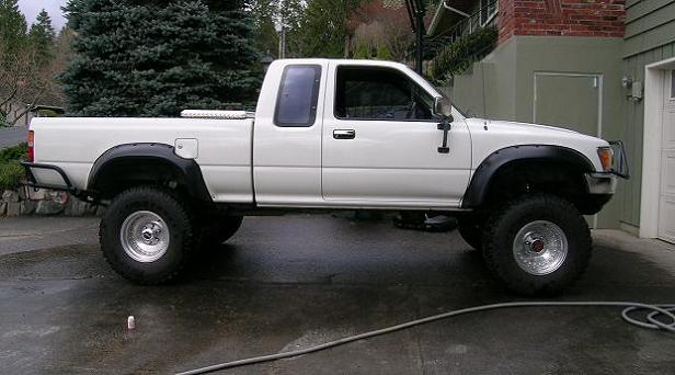

Hey guys! So this is my first post so bear with me if i make the rookie mistakes okay?
First for a quick introduction... What i have is an 89 extended cab Toyota pickup with a 3.0 V6. It was my first vehicle, had it since 16 and we've been through a lot together. *sniff*sniff* Okay okay so the truck has a 4" Rough Country IFS Lift kit, Marlin Crawler Rear Bumper, Downey 2" lift leafs, Downey Torsion Bars, Fabtech Desert Guard, Flowmaster 2.5" catback exhaust, IDelta Toolbox, Bushwacker Cut Out Fender flares and on and on and on....
Now! Onto the important stuff. The truck has 304,000 miles on the original motor... Unfortunately the transmission didn't make it this far though. It only made it to 296,000. Lol so it has a new transmission in it with only 8,000 miles on it! One more (probably important) fact is that the truck is sitting on 33x12.5 Cooper Discoverers on 10" wide rims.
Okay okay so after all that introduction, here's the problem: The truck has ZERO guts. She runs and drives like a top! Leaks a little oil (leaky valve covers i think) but makes no bad sounds, vibrations, no nothin. I have never had a single problem with the truck. She has never let me down and I've had the truck for 5 years now. I love the thing to death but it's bad. I'm a college student that needs to be able to drive this thing on the freeway without fearing every hill between A and B. I usually get stuck in the right hand lane in 3rd gear doing 45 mph. And just to drive the point home, i was doing 65 mph in 4th gear and put my foot to the very floor. You know what happened? Absolutely nothing. Not an mph faster.
So what's a toyota lover to do? Is the engine just tuckered out? Should i look into replacing anything on the motor? Or should i look into replacing the motor all together...? My only other thought is towards gearing. Could regearing be the fix all to this problem or would new gears really not help?
I'm just hoping for some input, thoughts and/or experiences guys so if you have some ideas PLEASE let me know. I love the truck to death and need some help figuring out the best way to get her back on the road where she belongs. One more thing to consider is that i've got a budget for the build but i'm a college kid, my pockets aren't THAT deep. Lol
Thanks guys. Take care and happy driving.
PS: I've attached a picture of the 'ol girl
Attached Thumbnails Should i do a new engine, re-gear, or let the old Yota go...-tonya.jpg
