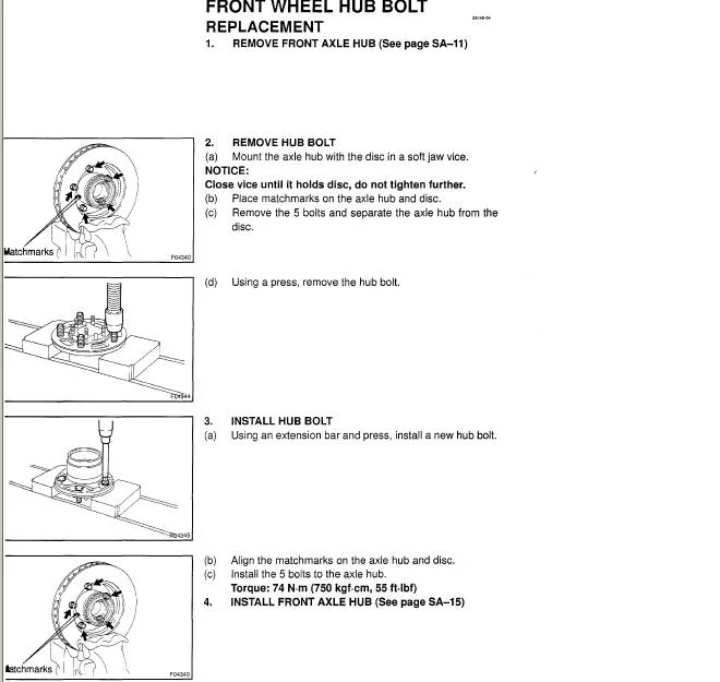

As per the original OP's question, I think he's looking for input on how to replace the wheels stud ie. DIY.
I'd also be interested on any help as I've got a wheel stud that needs replacing so that I can register my vehicle.
Old Aug 1, 2009 | 07:33 AM
Dublin's Avatar
Joined: Feb 2004
Posts: 903
From: Appleton, Wi. USA
Pics should help ya, the studs are about 6 bucks. In order to get to the front studs, you have to remove the entire rotor. Take off the hub cap and remove cotter pin and the large nut on there. Remove the hub and commence to pounding out the old studs HINT: use some wood to keep from messing the rotor up. Replacing is the reverse. Double check the spines on the studs. You can get them snug when you put your wheel back on. On the rear, just hit them out of the axle thru the back. Replacing is just putting them in from the back and snugging them with the wheel.
http://forum.ih8mud.com/attachment.p...1&d=1192296865
Old Aug 1, 2009 | 12:40 PM
wyoming9's Avatar
Posts: 13,381
Likes: 100
Red face
With a 4x4 remove the locking hub then the nuts and lock holding the wheel bearing .
pull off the rotor hub unit remove the 6 bolts holing the rotor to the hub separate the 2 pieces . I soak this good before. remove the broken stud I find air hammer is the best way. being careful. They also work great for stubborn cone washers.
To install the new studs or stud what ever is needed. I use a M12x1.50 stardard lug nut with the flat part to the bottom. using the half inch impact gun to pull it where it needs to be checking to make sure it is pulled in snug.
put it all back maybe replacing the wheel seal if you decide to pack the inner wheel bearing . A good thing to do if you have never been in there before.
