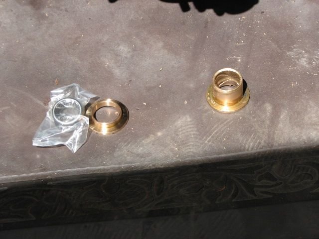

I had no clue as to what was causing a grinding and thunk sound coming from the front brakes and or suspension. Decided to change the hub spindle bushing. I found removing the old brass bushing became a major pain in the backside, I rented a slide hammer but found the jaws were too thick and would not grasp the narrow, if any clearance between the brass bushing and housing. I resorted to my arsenal of tools and make shift contraptions and after off and on attempts eventually able to move the bushing enough where the slide hammer was somewhat effective.
Posting pic's comparing old bushing to the bearing, found the price is approx. 1/2 but since I was unable to locate the kit thru an alternative source I ended up purchasing from the local Toyota Dealership; fortunately they only had 1 tube of the the chassis grease at $30 per tube but I was able to locate the same item thru a Toyota part supplier for $15 per tube.
Took for a short test drive and so far the grinding and thunk is no longer present however I am getting a slight grinding sound from the side I repaired and not certain if it could be due to new rotor, caliper, and pads breaking in. I checked and verified the pads are in the correct position and installed properly?
Comments/suggestions appreciated!!
