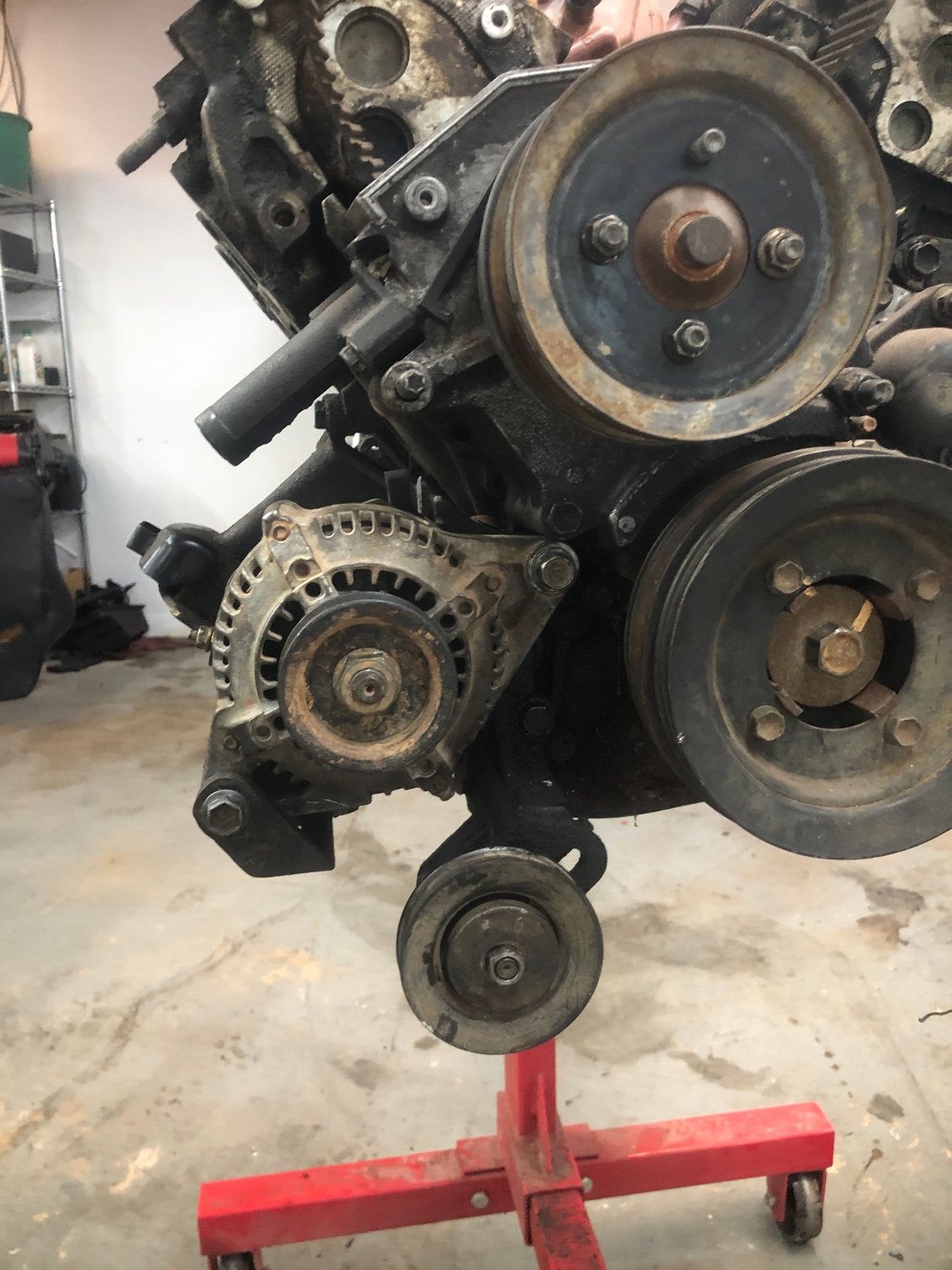

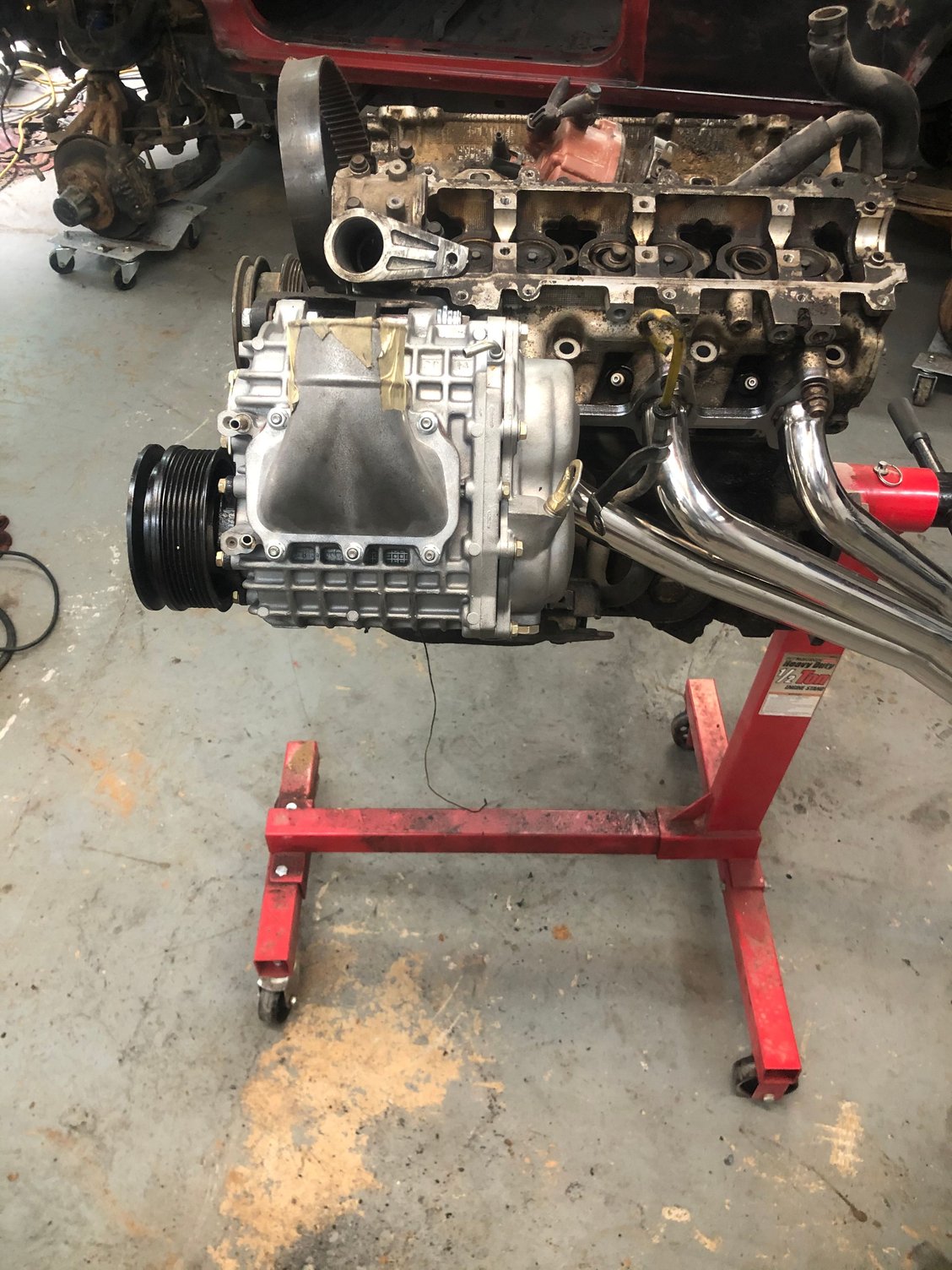

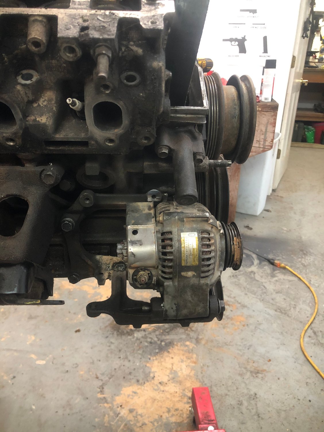

Sorry for time frame on reposting. Doing a lot of projects at the same time. But I finally got the mount finished for the supercharger. And relocated the alternator to the AC location and using the stock ac adjuster to make the belt work. Only issue with fitment in the engine bay is the inner fender which I knew would be an issue from the start and the steering shaft. But those two things should be easy to fix to make this work.

Just need to clean up the brackets and get better sized lock washers and it should be done. The alternator is now a solid mounted alternator and can’t move. Hence using the AC adjusters.
