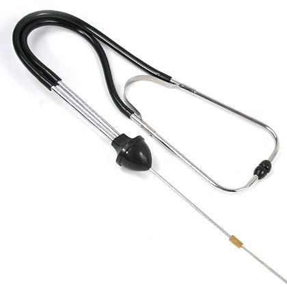

Any way you can rack it and run it up in the air?
these work great for situations like this. Auto technician stethoscope.
But I agree about the driveline. I'd look there first.
